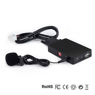

Link to the eBay page does not seem to be working anymore. Are you able to find it elsewhere or could you please post some pictures?
Just found something that looks similatr to the miniature picture on the auction linked above:
Can you please confirm this is the one? :)

Product description says that it would only work with CD43 radio. Has anyone tried it with BMW Business RDS PH7850?

It looks really good and I'm tempted, but not keen on installing an external mic.
Do you know if it can still do Bluetooth calls if the mic isn't plugged in, i.e. so the call still comes over the car speakers but it uses the phone mic instead?
Thanks!
Scooblitz
Aug 7, 2017
135
Glasgow, Scotland
2.8
Thanks!
Sadly not. It needs the mic via a 3.5mm headphone jack into the box to work. It has a clip to attach somewhere sensible without drilling. The call comes over the car speakers.

No once you have installed the unit then you need to use the external mic.
I have mine clipped to the top of the A pillar with the wires hidden behind the trim, but you could always get inventive and drill a somewhere pop a grill in and hide it behind to make it look “factory” though I do believe the official BMW phone upgrade of the time also used an external mic.
