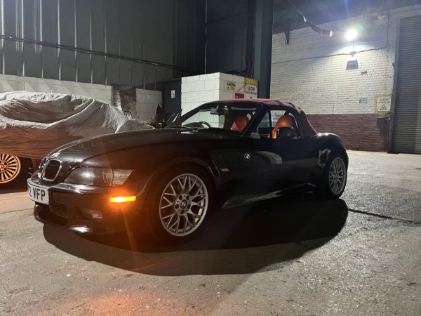

Had my first "spirited" run since the engine swap over the weekend, managed to get out around North Wales late one evening.
The car has now ticked the box of rekindling the fun I used to have when I first started driving.
The car feels like it has the right amount of power, doesn't feel like its lacking.
