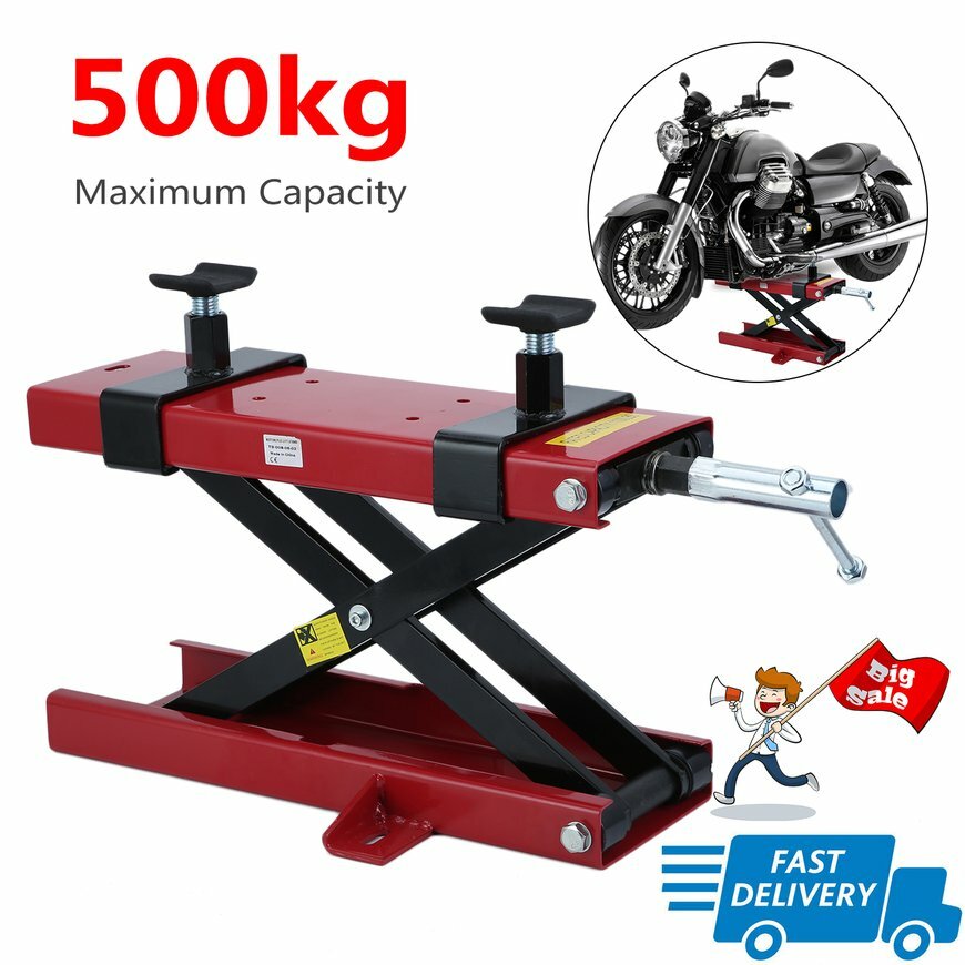

We're into the first of the photos I took now. And the decision point I took to remove the diff and then the beam as 2 seperate assemblies. I know the Zedshed do this in 1 maneouvre but they are well versed and on this occasion I was on my own with no James to help (girlfriends :().
I'd asked Father Christmas for one of these last year with gearbox and diff removal in mind. They are about £30 and to cut to the chase it worked like a dream. I didn't use the cradles.
So I jacked this up under the diff to just start taking the weight. And undid the hanger bolt. I then lowered it enough on the jack to remove the four bolts securing the diff to the beam. These sit very high and you won't get a tool in without doing this. I used a ring spanner and heavy lump hammer as the bolts are on tight.
At this point the diff is almost free to drop but needs help off the end of the propshaft. It will need to go lower until it clears the hanger bracket on the floor pan. By this time I was hearing some distressing noises as I'd forgot to remove the heatshield but the only damage was to the heatshield itself and this can be fixed. The propshaft is capable of flexing down some distance to help with this step. Once clear of the mounting bracket the diff can be wiggled backwardwas until it breaks from the propshaft. This step was a little more tricky than I expected and did need quite a bit of persuasion.
And can then be lowered to the floor. Being an LSD it's heavy.

I like your solution to dropping it by your self. I used a jack which went ok but so could have not. I’ll be buying one of those to reinstall much better and safer than the approach I was looking at making a cradle out of wood to fit on a jack.
I considered the jack. I've dropped a complete rear axle (with exhaust off) on a breaker before but it's very unstable.
I also looked at the wooden cradle for the diff. It's relatively simple to do I would think. It would also give more wriggle-ability to get the diff off the propshaft. But I guess I was a bit lazy and didn't want to spend 1-2 hours trying to make it when I wasn't sure how successful it would be.
It remains to be seen how clever the motorcyle jack is for getting it back but I would guess that end of things is the more tricky whatever approach you take. But it was spot-on for getting it off.

...but so could have not
I think that's the #1 priority ultimately isn't it, ie safety. That diff is bl**dy heavy if it falls off and lands on you. Not to mention the damage to the diff that could occur. It's not for those who don't like being under cars or for the gung-ho pulling the rear end apart.

I think sitting that motorcycle jack on some rollers or a sturdy board with some casters would be a better solution. Glad you posted this it will save some ball ache with my reinstall.
Very good point. I shall look out for such a thing. I think Lidl/Aldi might even have had a roller-board recently.
