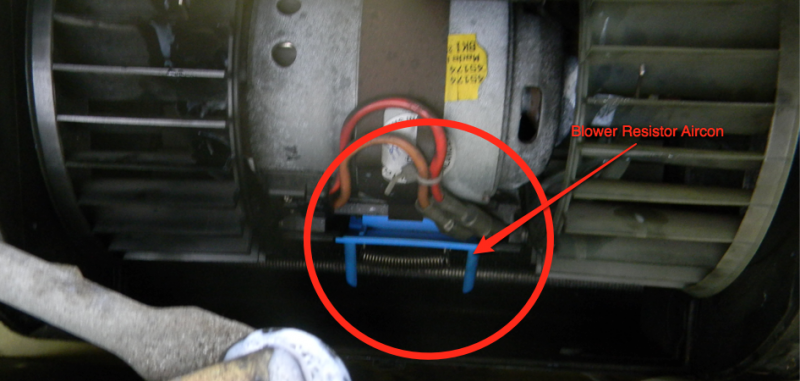

A common problem for our cars as they get older is a failed blower resistor, the symptoms for this is the fan only works on speed 4 (max). The blower resistor comes as two different parts depending upon the specification of your car.
If your car has air conditioning, the blower resistor is located outside the car under the windscreen scuttle panel.
If you car does not have air-conditioing the blower resistor is located within the cabin behind the panel on the right hand side of the passenger footwell. (RHD Cars)

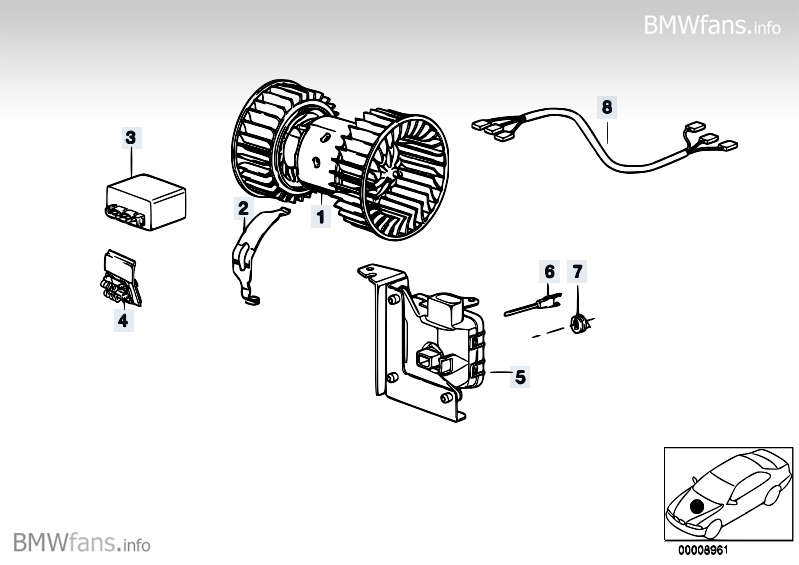

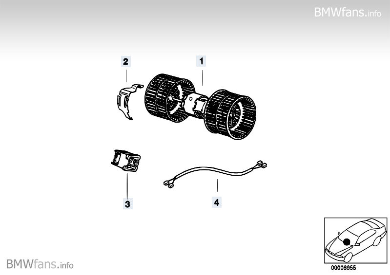

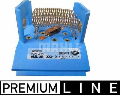

You can see below that the resistor part for Air-con and non Air-con are different.
Blower Heater Resistor Non Air-con - 64111375754 - Part 3
Electric parts for heater -
BMW parts catalog
Blower Heater Resister Air-con - 64116912633 - Part 4
Electric parts for ac unit -
BMW parts catalog
To get to the resistor on the cars with air-con you will need to do the following: -
1. Raise the bonnet

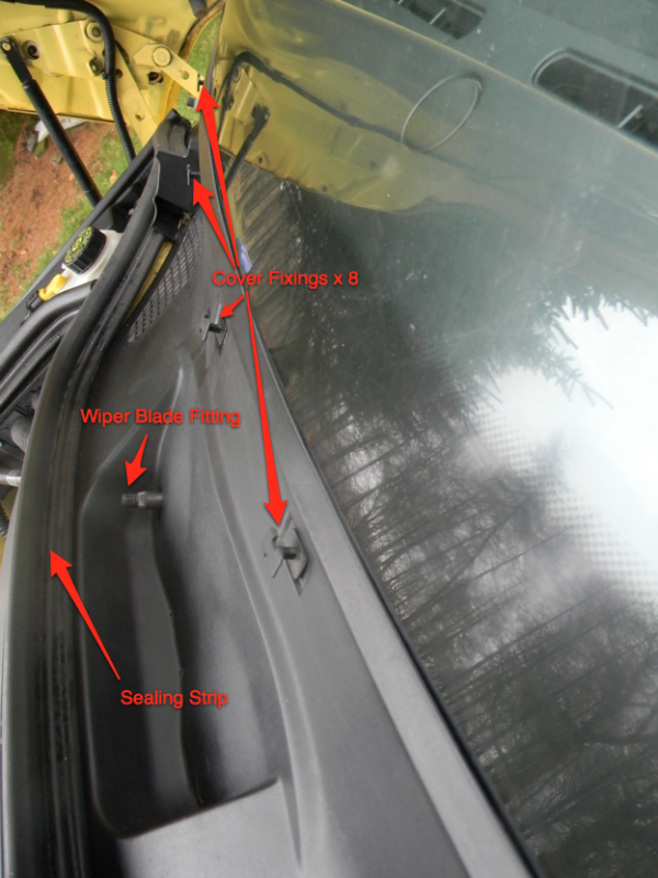

2. Remove the 2 plastic caps on the wiper blade nuts, these just prise off.
3. Remove the wiper blade nuts and wiper blade arms.

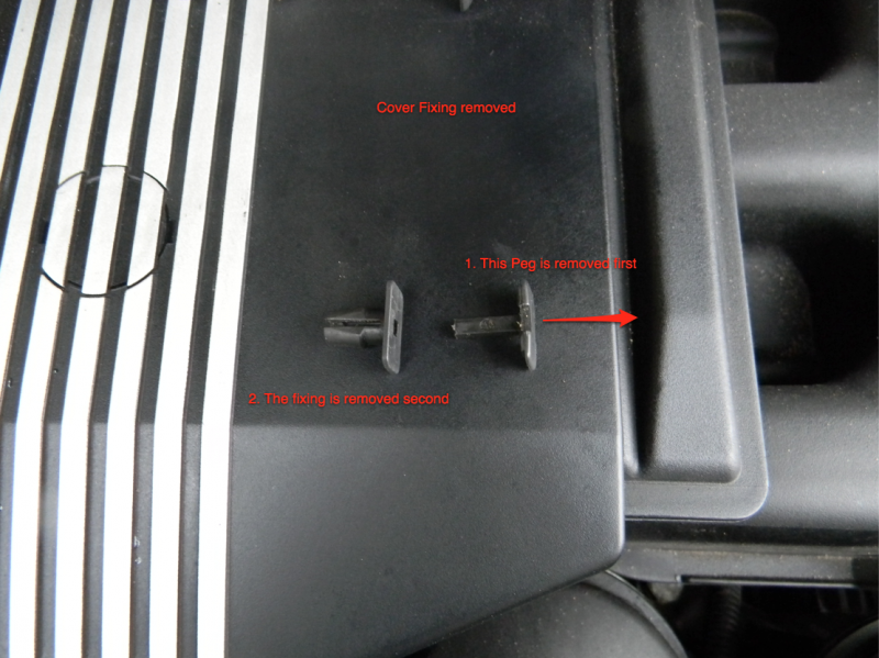

4. Release all 8 cover fixings just under the windscreen.
5. Remove the sealing strip along the far side of the cover strip.
6. Lift off the plastic scuttle cover strip.

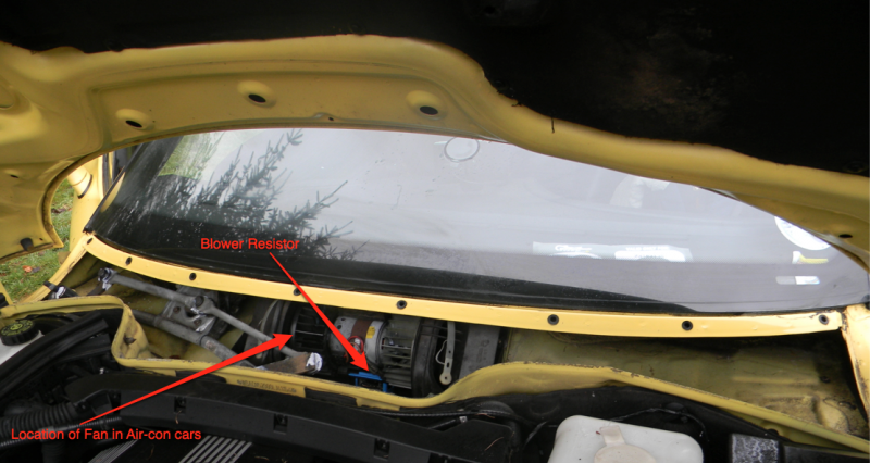

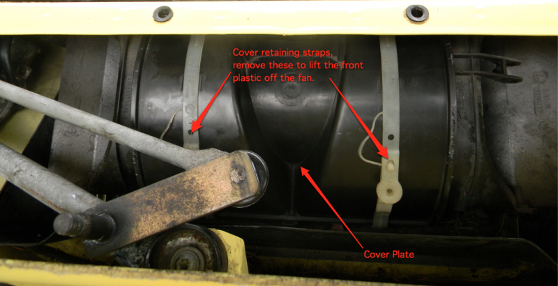

7. Undo the two retaining straps around the fan shroud.
8. Remove the top fan shroud cover.
9. The resistor pulls upward from the centre of the fan in an arc, the wires and connector for the resistor are captive as part of the fan unit.
10. Install new unit and put back together.
