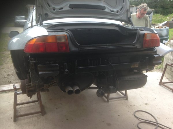

So I Have fitted a really nice Tow bar. Mod. The Roadster can only pull up to 1/2 tonne. No more because if you did go heavier you would damage your chassis. Which if you have never seen it is below in the pictures. It is not a heavily built chassis making it lighter.

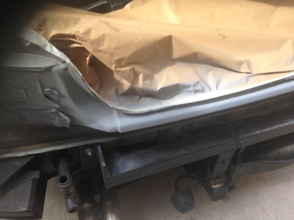

Watling motors do a special bar assembly that is really subtle. All you see is the square section under the rear bumper for the removable tow bar. There is no need to cut the bumper which is good. This is a WIP and I am still assembling her after a strip down and re-spray. But this is the Tow bar fitted with the bumper off. Before the spray up. It took 2 hours.

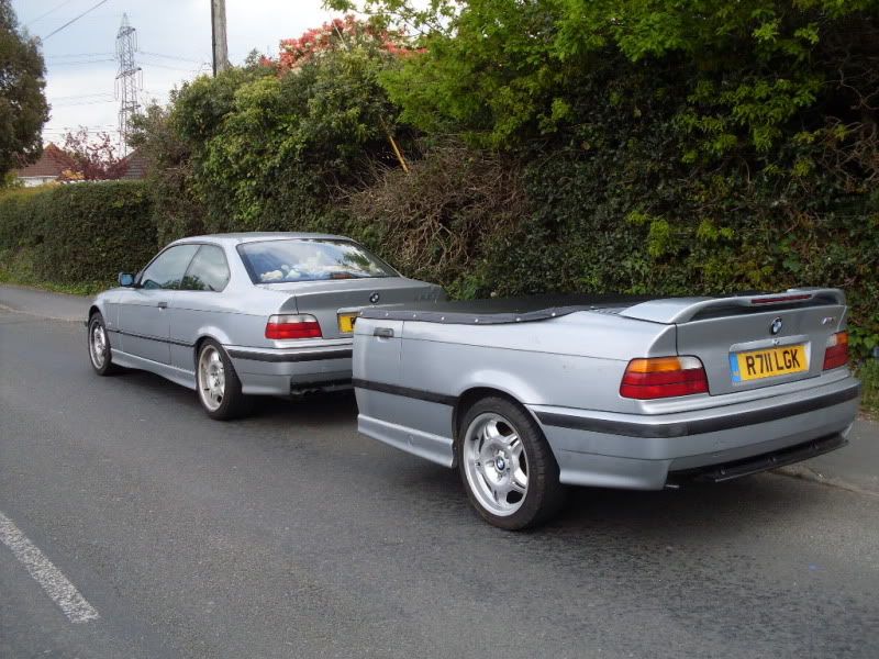

The good thing is now I can pick up bigger stuff in a lightweight trailer (like you could with an estate) opening up more opportunity to drive her for small tasksIMG_1656.JPG IMG_1659.JPG .
Towing Weight limit here though must be adhered to. I think you can apply this mod onto roadsters to 1998. though you need to check..

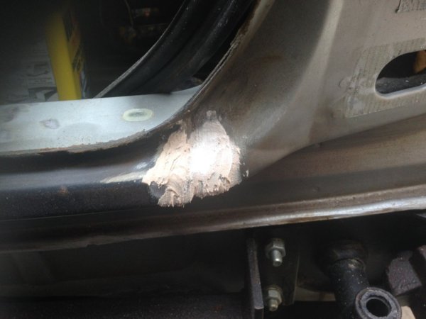

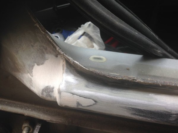

More Pics to this ... As part of the strip and repaint I went round the body looking for areas that had corrosion caused by the design. The worst parts were where the Boot drains down over the rear light assemblies.
So a bit of welding, filling and repainting were in Order. The good thing is that none of the spraying and wax oiling can be seen when the bumpers back on. Subsequently I think the work done may prevent future work.

Cost was 248, and it did not need a relay box on my wiring...Fitted it myself. Only difficult thing was a self fixing hole nut under the passenger seat that needed a fiddle fix and pre compress with the bolt that holds the long stay arm in place.
While the back bumper was off I also wax oiled the entire back panel, and underneath...
