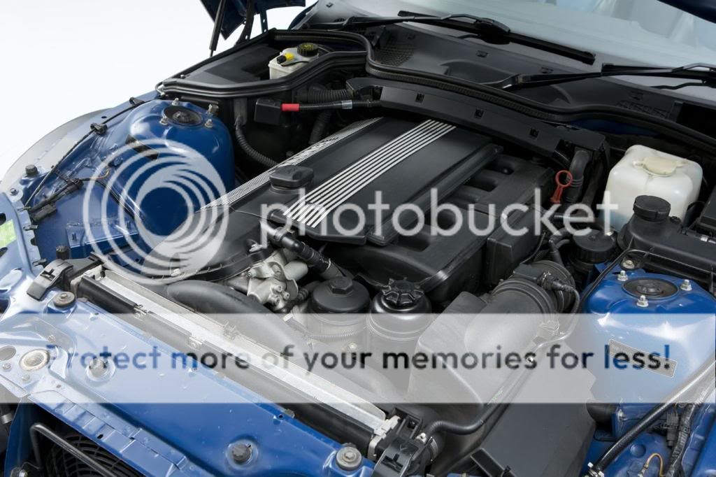

Here's mine 'tis an M54 3.0 but very similar to the 2.0 M52 engine.
You can just see the cam cover breather pipe wrapped just above the oil filter cap.

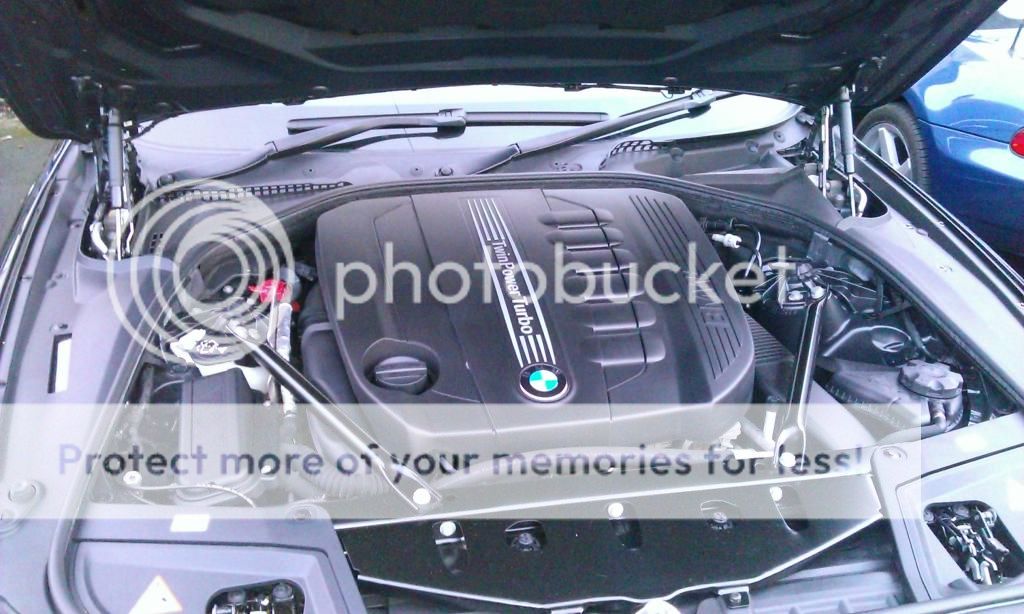

nearly 90 k but try to keep it nice. only weekend and sits on the drive all day. The seals around the bonnets are pretty good so not much gets in. This one I haven't done any thing too only 30k though.
Looking very nice, I like the blue top especially. When I get saved enough for my top replacement it going to be green, so I hope the overall effect will look as good as yours.:)
