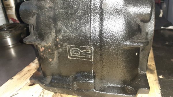

I have never put my hand to this differential and at first sight I find it different from the standard LSD ones where on the cabinet there is the letter "S" while in that of the Z3 there is the letter "R" someone knows what the letter "r"?

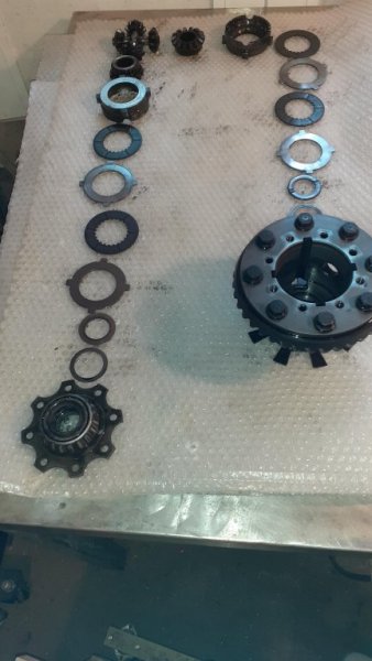

To understand more, I opened it and found a strange situation.
It is a clutch disc differential only that unlike other differentials inside I did not find the preload discs but only 4 clutch discs coupled to the 4 dog's ear discs.
I have a feeling that the owner before me has somehow "tampered with" by replacing the preload discs with 2 other clutch discs to have a greater locking but these are just my hypotheses and I ask you if you have ever experienced this type of differential.
I am attaching a photo of the components of the differential lock arranged in a disassembly sequence and if anyone notices any additional or missing components, I thank them infinitely for the help.

Hi, could it be a Z3M diff? Same length output shafts as the 1.9 and I think the M diff is a 4 clutch arrangement.

my strong doubt is that there are no plate springs
in fact, without the plate springs there is no initial holding torque and it behaves as if it were an open differential.
therefore this is the original configuration?

It looks like an M diff. I have a video that I haven't edited yet that shows me rebuilding my diff.
When you bolt it together, you test it by measuring the torque required to turn the diff. I made a tool to lock the diff - it is basically a long bar that locks one output shaft - you measure the torque required to turn the other output shaft.
If you need new clutches, you can get them from Porsche. They are ZF, but ZF won't supply them, but you can get them from Porsche. I didn't need any, so I don't have any links, but Google is your friend. I think they are used on the 924 or the 944 - I can't remember.

?? the Euro 2.8, 3.0 & M are type 188 diff not sure about the other engine sizes. The "R" I'm reasonably sure stands for Remanufactured, as in factory replacement.

R is thought to mean 'Rutschsicher' or non slip. Older E30 era stuff has 'S' for Sperre or 'lock'.
Reconditioned in German is 'Ueberholt'.
1996 is about the last year of the metal diff ID tags before the white plastic ID sticker on top of the diff.
That looks like a 3.45 ratio small case (168) Z3 1.9 LSD. Some more photos of the casing and rear cover would be helpful.

Type 168 3.45, casting manufactured December 21st 1995.

This may answer your question as to why there are 4 clutches and no pre-load? ........ found on another forum
I can provide a partial answer: only the later LSDs in Z3s seem to be Torsen. My 1998 2.8 6-cylinder has a clutch-pack LSD, as I believe they all did. The VIN decoder says: "S209A, SPERRDIFFERENTIAL 25%, Differential lock 25%." The bar code tag on the diff says: "1428258/E3204J;3.15." It turned out to be a Msport version with 4 clutches instead of the standard 2 clutches, along with asymmetric ramps and no pre-load.
