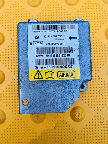

Hi...I believe it is an Airbag ECU.
Part number: 65. 77-8386192
So, guys...anybody know of one for sale with these numbers please..?..I've looked all over but can't find one.
Am I right in thinking: If I get hold of one with this serial number, I just whip out the old one and pop the new 2nd hand one in BUT then have to go and get it coded?
Many thanks.

The part number you quote is the main airbag module fitted to the centre console. Real OEM search on the part number shows a couple of other modules that can be used on your car retrospctively depending on the year of your car. So if you cannot souce one with your part number then look for one of the other compatable units. Replacement will need coding to your car using NCS Expeert otherwise you will have an airbag code and the light set on the dash. https://www.realoem.com/bmw/enUS/partxref?q=65.+77-8386192

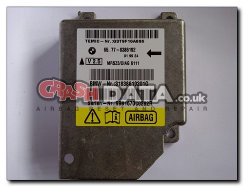

I've also found this:
But they say they can only fix certain codes...So I shall have to get the car hooked up to read the fault code once I get it.

Crash Data can remove the crash data on a module if its been locked up following an accident, it has to be done by direct reading of the eeprom chip on the circuit board with different software. What code is your current module setting, if its an internal fault the module is probably unrepirable. Best course of action would be to obtain a replacement from the UK and hope its not from a crashed car thats locked it up.

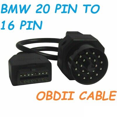

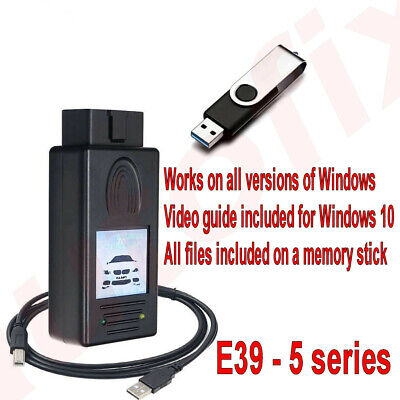

The cable that comes with the BCables kit has no switch but should work with the software included. The other cable type you can buy has a switch for the two types of system on the model range. The Non switch cable should do for your car.
Raggie
Mar 6, 2021
24
Unfortunately I was too late to buy the BCable...So I am looking for another cable which comes with the same software. I have found this (do you think it will work..In the description it doesn't mention the E36 engine) It also has a switch:
