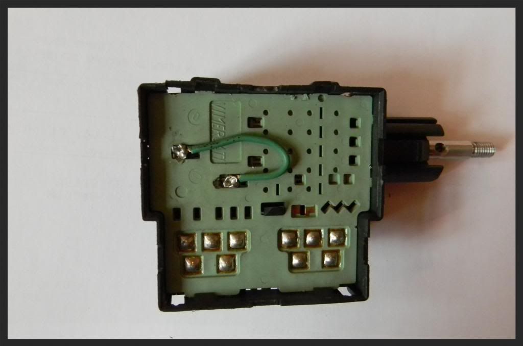

Yes you should, the rheostat is the weak link in the circuit, the dash lights are not fused independently and therefore blows the rheostat in the event of a short in the lighting circuit.
The cage on the back of the light comes off, you can see below the link put in place to bridge out the rheostat, these are the pins you are looking for (not my soldering BTW)

I tried this on the old one, but it made no difference, they were still off. If i replace the new one with the old one, cut the wire then test for a voltage, it should tell me if there is power going to the lights shouldn't it. Also if I take a live feed (from the cigarette socket) and connect one of the wires the dash should light shouldn't it, unless there is a grounding problem?
If you tried this on the old one and nothing lit up then you have a supply problem, As you suggest you try and put a temp supply on the output wire of the light switch, this should light up the dash etc. Take care to put a fuse in line though just in case.
