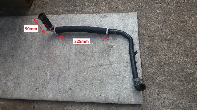

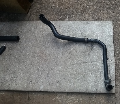

The tube goes from the air filter box to the emissions pump. If the hose fails it can be replaced for less than £10, not the £100 that BMW want.

The original pipe...
The repaired pipe...
Use 28mm radiator hose (500mm length found on eBay for £4), some jubilee hose clips and a 28mm copper elbow from B+Q (£2.13).
The removal and refit is a bit of a faff, but the best way to do the job should be obvious to anyone who attempts it.
