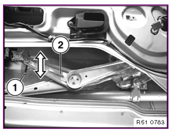

Both windows have a bmw logo and some other text in the back corner, I noticed that the one on the passenger side was way higher up then the driver side. So that will be my next quest; adjust the window height. I remember reading somewhere that it's possible to do that. When you have the door card off. I'll have to check TIS just to be sure though.
Safe so say that changing the window sliders makes a huge difference though!
Update:
Found it already, need to adjust screw #1
Another update:
I've adjusted the screw (#1 in pic above) so the window sits a lot higher. Water still leaks in through the gap of the two seals, but I'm not too worried about that, it's minimal. I did a test for before and after and while before the water would come done on the inside of the window, now it only leaks through that one seal when spraying water directly on it. Unfortunately can't tell if this actually reduced wind noise until I got the hardtop on in a week or two, so I'll check back then.
