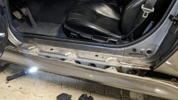

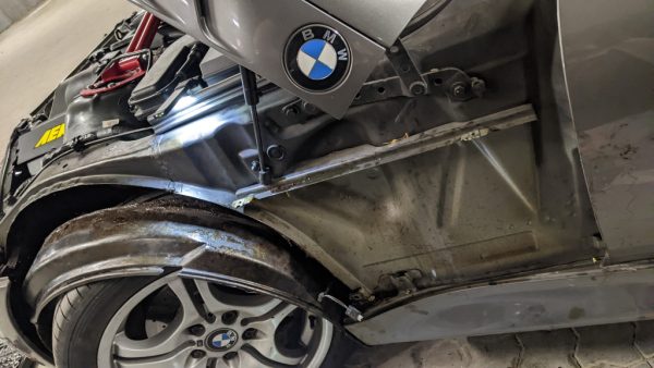

Update: so finally got around to fitting the first of the panels, the job was not too bad as you guys said pretty straightforward, I didn't even remove the wheels, and the only issue was the rust treatment coat which is just a mess to work with.

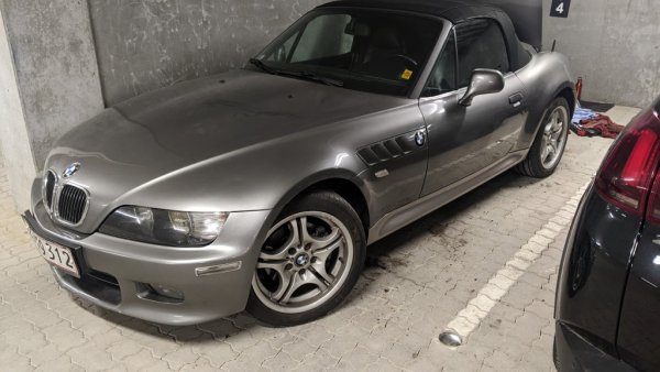

So slight problem and I am panicking, the color that the official BMW workshop has painted doesn't match my color, although on the receipt it says 472 Sterling grey.
Has anybody experienced that? Did they make a mistake because even the interior panels do not match the color that they have painted the new rocker panels...🧐

Either they have sprayed the panels with the colour or less likely the car has had a respray in the past and a colour change that isn't the factory colour code? The inner panels won't match the outer ones, that normal.
So are you saying that probably they probably made a mistake?
My point is that even the inner panels i.e. around the trunk match the rest of my car colour while the newly painted panels by BMW do not... Is it just that the rest of the car paint has oxidized or should I make a claim from them that it's the wrong color? 😞

There is my point. BMW don't use top coat on the inner panels, as in the trunk water runs etc so if that matches the top coat I would say there is a chance the car has had a respray. Have a good look for other evidence of a respray, overspray etc before you go back and complain.

I see your point, but I cannot judge an "overspray" or "respray", until now my Z's color seemed good as expected 🤔
In any case I have to go back to them and ask them to either match the new panels to the body color or do a full respray the car body which sounds extremely expensive?
I don't see any either options, and I believe a paint correction like polishing cannot fix this difference, right?
No they seem two totally different colours, the sills look almost like Titan Silver??
Exactly, it does look like Titan Silver and that is why I feel that perhaps they did a mistake... I am going on Wednesday by the workshop, hopefully, they understand 🤞
