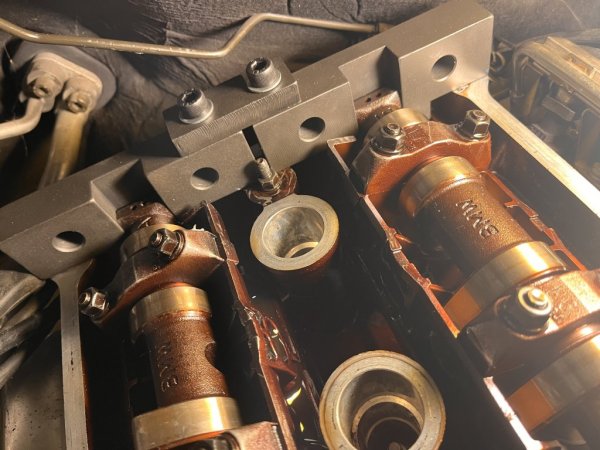

Hi All, new to BMW but trying to learn as much as I can, bought my first bimmer 2002 Z3 M last month, last owner had taken out the bulb for engine light, long story short, after several attempts got most faults clear but stuck on P0011, I have read several posts on Vanos timing including videos by 50s kid. I have checked and rechecked everything several times but after I set my timing and then rotate 360 degrees to get back to TDC the intake camshaft looks to be advanced and the tool doesn’t fit on the back of the engine but the exhaust side looks fine. What could be wrong here??

We will need history on repairs that have been done (or you suspect may have been done).
I've done videos on timing the camshaft for the S50B32, but the VANOS on the S54 is different to the S50, so I don't know how relevant they will be.

Yes you have the M54. Thank you for confirming that.
Check your timing jig. The 2 blanks that the VANOS cup press up to can get loose. Check that the grub screws that hold them are tight.
thanks, i am pretty sure they are tight but will double check tonight. any other thoughts?

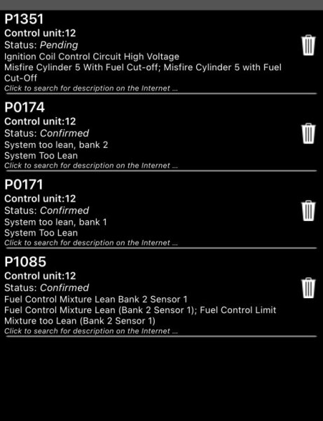

Back at it again and need advice. After repairing vanos and all codes cleared, drove the vehicle for about 15 miles now I have following codes see photo. Any idea??
colb
Nov 25, 2012
178
Newport, South Wales,UK
Lean codes usually down to air leaks after the Maf check all rubber intake boots and vacuum pipes across the engine for holes or splits. If you had the cam cover off ensure the gasket resealed ok. Smoke test the engine if you can't find any leaks visually
Zaniei3
Jan 16, 2025
18
Fort Worth
Roadster 3.0i
Thank you. Can you elaborate more on the smoke test please?
colb
Nov 25, 2012
178
Loads of YouTube videos on smoke testing, on BMW's take the Maf off and pump the smoke down the inlet boot with throttle held open so smoke gets inside the engine, watch for signs of smoke escaping across the engine and you will find your leak if you have one.

Your smoke bit could be a future friend as vacuum leaks can sometimes be a problem.

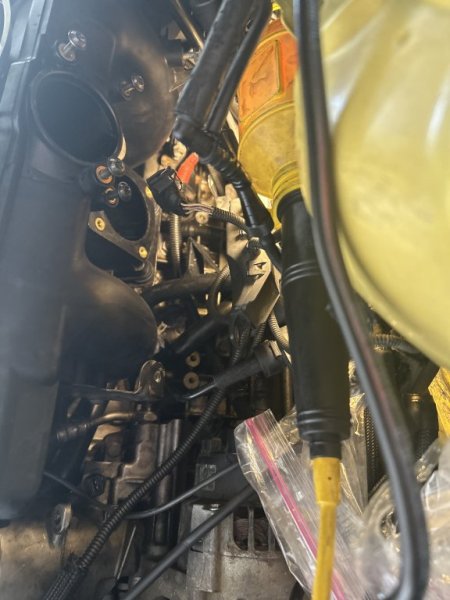

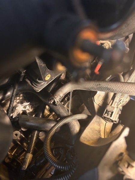

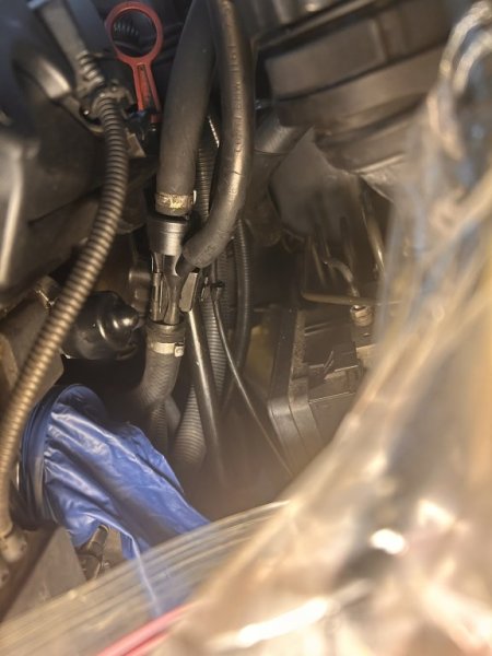

Question. How do I install the hose clamp at the back? I can’t even see it!
With what real mechanics call the eyes in their finger tips.
