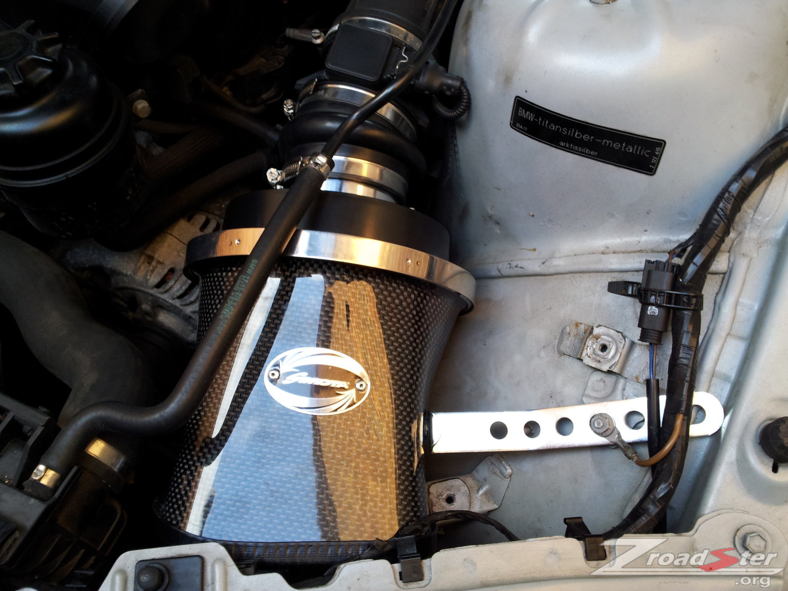

@Lee I got in touch with the local powerflow dealer and they reckon £450 for the full exhaust, customised etc and fitted, sound reasonable? I presume cat back would be cutting corners..
@GazHyde I've taken a look at the airbox fogging guide, when you fitted the simota did you make any changes to the cold air feed?

Ash. The Simota replaces the air box in its entirety and fixes on to the MAF. The carbon fibre makes a funnel for the incoming air and can give a small ram effect (doubt that much in reality).

Is that not still relying on the cold air from the kidney grille which feeds the std air box?
Yes it does. As far as I understand it, as with any cone filter replacement it allows more air in to the intake. The carbon fibre bit funnels the air in to the filter, and also keeps out the warm engine bay air out of the filter. I'm sure someone can explain it better than me though. All I know in practice the engine generally ran smoother than with the OEM box.
