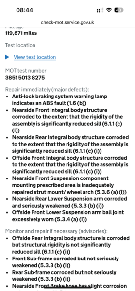

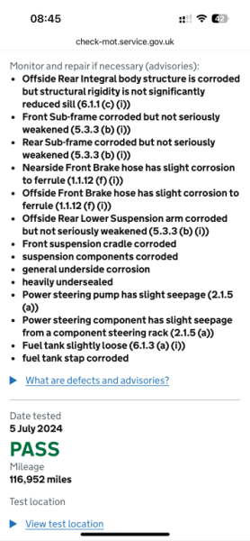

Morning and hello! New member here, purchased a 1999 2.8 (120k miles) in march and it’s just had first mot since. Long list of failures including welding.
Love the car and really just want to find out if they are worth saving or if I should just break what I can and scrap the rest.
Has anyone had long term success after welding or is the car always going to deteriorate further?
Been quoted about £2k+/- to get it through the ticket. The welder is nervous about how much will need to be cut back etc and didn’t want to under quote. It could be less they say…
Interior is immaculate and everything that isn’t underneath the car is in good shape.
