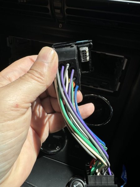

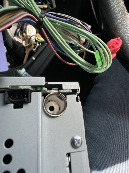

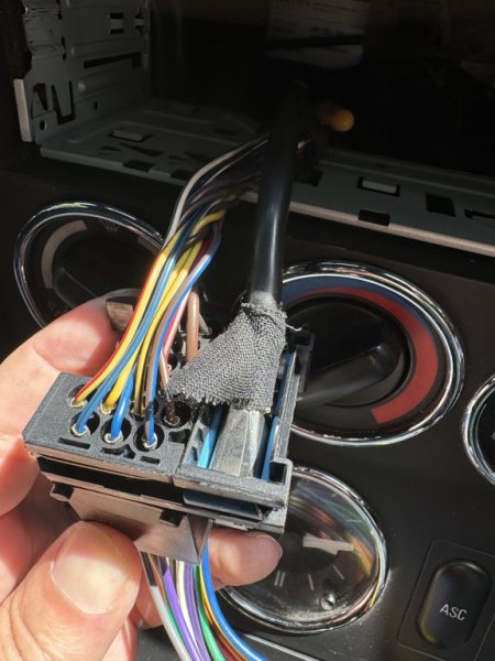

You won't get any rection with no aerial plugged in.
Does the new aerial have a lead? You'll have to run it through and then plug it into the radio.
colb
Nov 25, 2012
178
Newport, South Wales,UK
Oem Aerial cable should run from the boot through the car and emerge in the dashboard behind the radio. Just have a feel around through the radio housing gap, its probably fallen down in there. If you find it its either got a aerial plug on the end or a flat type connector that needs an adapter to connect it to the radio unit.
