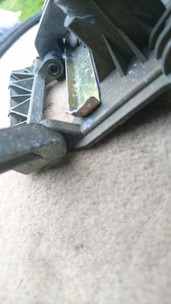

This is what the inside of the door handle looks like, the goldy (pitted) coloured 'slider plate' mentioned later can be seen here - about 6 inches long running horizontally just below the door handle hinge (slightly U shaped).
You can also see the handle's connection to the door actuator on the left of the picture which needs a jiggle later (on passengers side - drivers side has a linkage too).
The plastic plug that is in step 1 can also be seen on the left for reference.

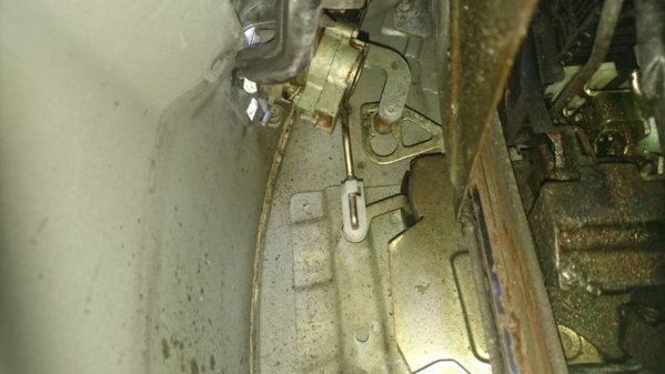

4th - From inside of the door - with a flat screwdriver gently lift upwards and push sideways the locking gadget (small square item straddling a pin in middle of this picture) holding a retaining pin (loose in picture above).
5th - Use a pair of long nose pliers to twist off the nut holding the barrel to the door.
6th - The only things holding it on now is
- The stud linked to the door actuator by a push fit - needs a jiggle - you can see the large cavity it has for this purpose
- The electrical connector for central locking - not shown, a black cir-clip needs to be removed from the yellow connector before it with pull apart.
- A skinny gold linkage - the white retaining clip needs to be prised off sideways with a flat screwdriver then it just falls off
These need to be gentle prised open in predictable ways.
