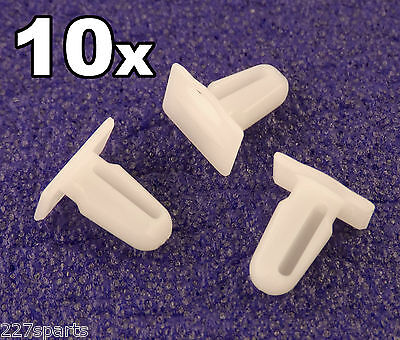

You will need some replacement trim clips for the door threshold covers, they tend to snap when you dismantle the trim, you can find them on ebay for resonable money, they sell them in packs of 10 so buy 2 packs

I do have a big trade box of all types of plastic fastners so will check that first, the stainless screws are a good idea and I do have a big box of those left over from a Lambretta rebuild so will check those too.
