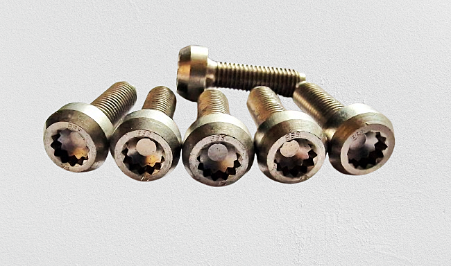

Hi,
I have posted in the wanted section for used or new bolts to fit 17inch staggered style 42 split rim (36111094373 and 36111094374).
I checked and BMW doesn't have a part number for the actual bolts. The bolts have BBS stamp on it, so it makes sense there is no BMW part number.
Does any know what are they made from (Titanium??) and can they be sourced new?
Thanks
As an update I contacted BBS who were brilliant and replied quickly. The wheels were a private label commission by BMW which means they have no data and if they did have data they couldn't provide it. I have reached out to BMW UK.
I see a set of 100 (for 5 wheels) for £275.00 plus vat and postage!! They look like the correct ones but not totally sure they are the correct ones.

Does anyone know if the original bolts for style 42 rims are Titanium Spline head M7 x24.5mm colour raw?
As far as I’m aware that type of slit rim bolt are all titanium. Not sure of the size on Style 42. Surely you can just measure what came out.
I’ve done a set of Mini web style alloys and those were titanium, about to split the style 108’s on my Z4, those look to be the same. If any are damaged I’ll get them from SRR, I’m aware people want bolts with BBS stamped on them, but really, who’s going to notice, especially once they get some brake dust on them.
Best to ultrasonic clean the threads and they come out spotless, ti galls easily if wire brushed and that affects the torque. Heads polish very nicely, though I have access to a polishing lathe and a variety of compounds. Ti has low surface hardness compared to stainless, so very fast to polish, about 90 sec per head.
Use threadlock, not anti seize and a decent torque wrench.
