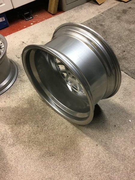

The last couple of sets of split rims I have sold to members I had split, Refurbed and had the rims finished in a ‘Chrome finish’ paint which looks like the wheels have been machined (as picture) but you have the comfort of knowing they are much more resistant to stone chipping and salt. Really it’s down to personal choice,
Changing or refurbing wheels is probably the single most important and aesthetically pleasing change you can make to any car, not only will your car look great but it will almost certainly drive better on 17 or 18” alloys.
Staggered sets command a much higher premium than a square set.
The attached pictures are original silver painted centres and painted rims “Chrome finish’.

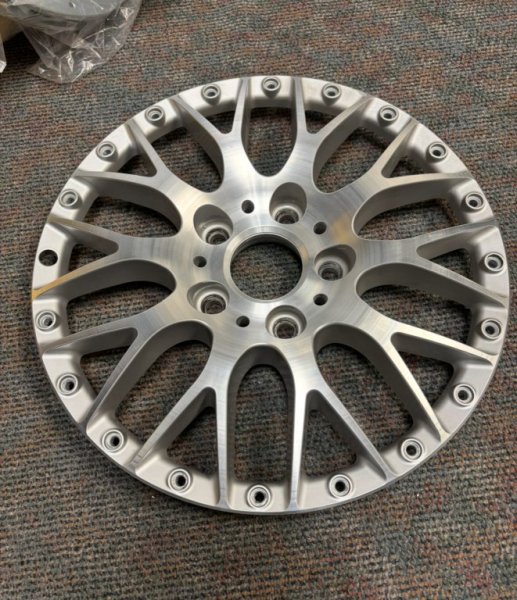

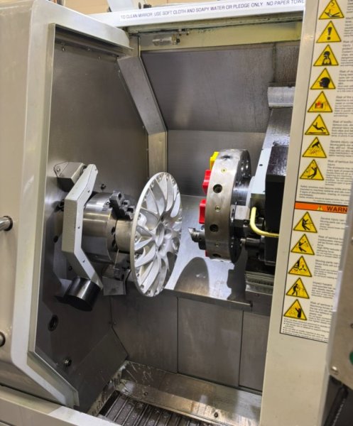

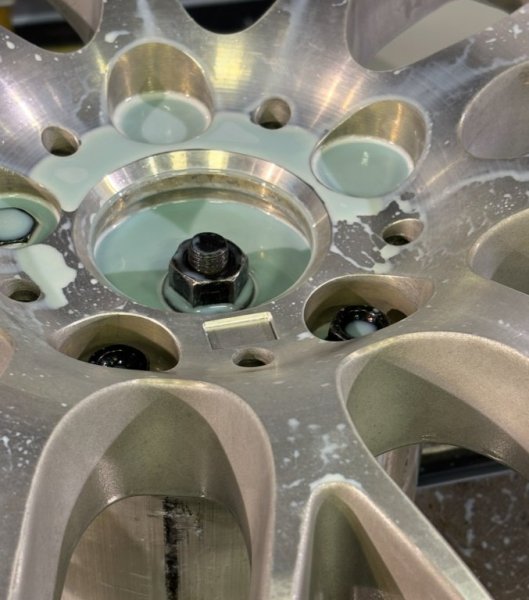

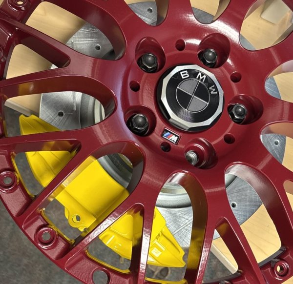

I bought a set of RS740 wheels and have done some custom work to give them a personal touch.

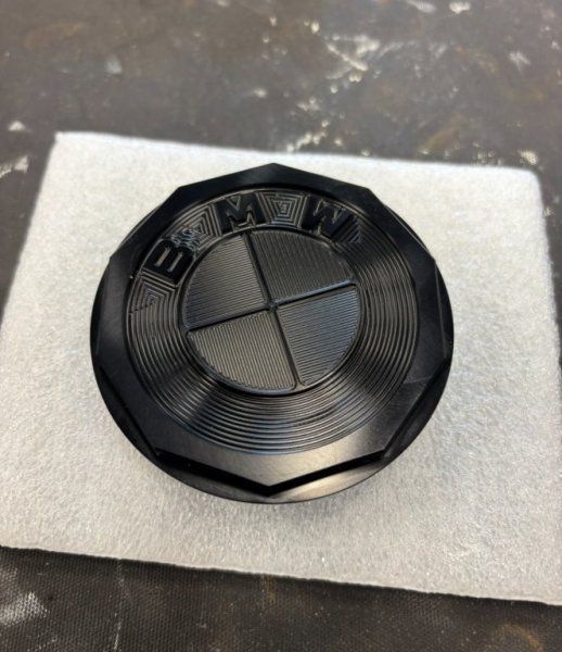

I measured the face profile, then machined it to remove the text around the bore, as the wheels will have a different width and stand off when finished. I might do some laser powder inlay with the proper specs. I also cut pockets to accept the missing BMW M decals. As for the center caps, I found them less than impressive, rattling, and cheap-looking, so I made some custom center caps that I had anodized and then remachined to add some contrast.
I'm not sure about the colour; I matched it to the new burgundy top that I will be installing sometime soon.
