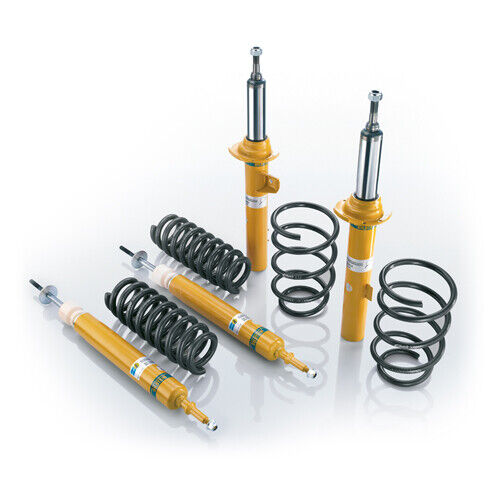

Appreciate it might be outside your budget, but have been very impressed with a Bilstein B12 suspension kit (Bilstein B8 shocks) fitted about 2 years ago. Think the kit was around £800, but good value for money IMO. My approach has always been to buy the best I can afford. Would be very wary of cheap, don't know about TA ones either. :thumbsup:

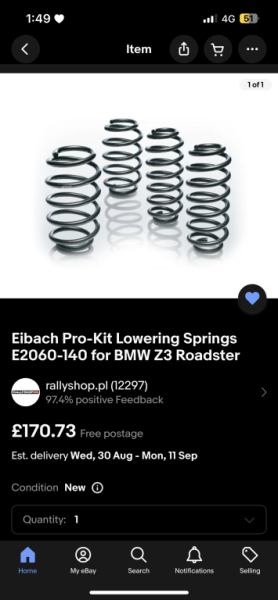

Ive seen these springs on eBay so I may just purchase these for now and not replace the coilovers just yet.
These should give me the same ride heigh I currently have and I suppose there reasonably good springs?

Oh these the bilstein ones you mentioned? @Ianmc
Looks like it, with B8 shocks. Think they lowered slightly less than the 30mm mentioned, but think the stance is just right. Worth the investment if you can stretch to it! :thumbsup:

Any reviews/opinions on these?
I put the B12 kit on my e89, great setup, didn't ruin the ride but improved the handling no end.

think im just gonna get the springs for now to get her back on the road but these will be a future upgrade for sure.

Another vote for B12 kit. Replaced my tired shocks and springs with it last year and the difference is night and day. Slightly lower as has been said, but just the right amount.
