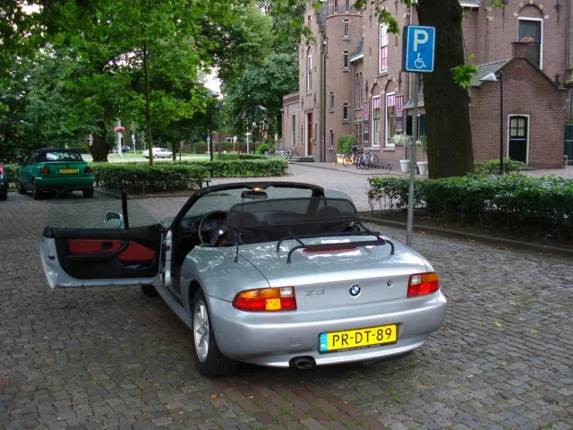

It will ether be a Type 1 or Type 2.
Type 1 fits in the turret mounts, Type 2 fits on the 'parcel shelf' for want of a better word.

This is mine prior to its hoops upgrade. Under the "parcel shelf" there are two hollow metal tubes screwed in that take the pins of the deflector.

This is a Type 1 on my car........
