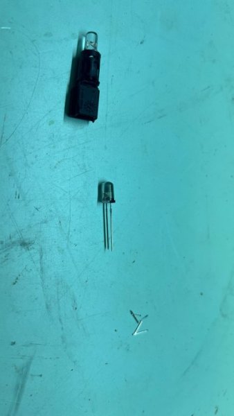

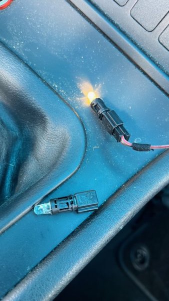

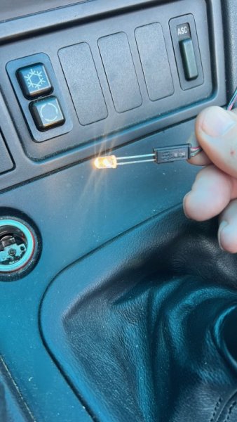

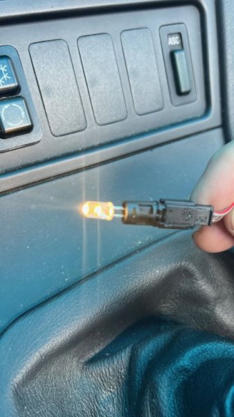

I too had a burnt out bulb in the climate control on my Z3, I nearly fainted at the cost of the replacement bulbs. Being the cheap skate that I am, I removed the glass portion from the lamp, then pulled the two small wires out of the base, enlarged the holes made by the wires with a tiny drill bit and then inserted a 12V warm white LED. Here in Canada, they can be had for about $1 CDN (that’s about 50p in the UK). I found the 5MM size to fit quite well, the current draw is 1/8th of the incandescent bulb and LEDs are known for their longevity. So I managed to save a few bucks (beer money). Easy peasy if you have a few spare minutes. The work is getting access to the controller described in the thread above. I have added a few pictures, hopefully this might help someone else.
