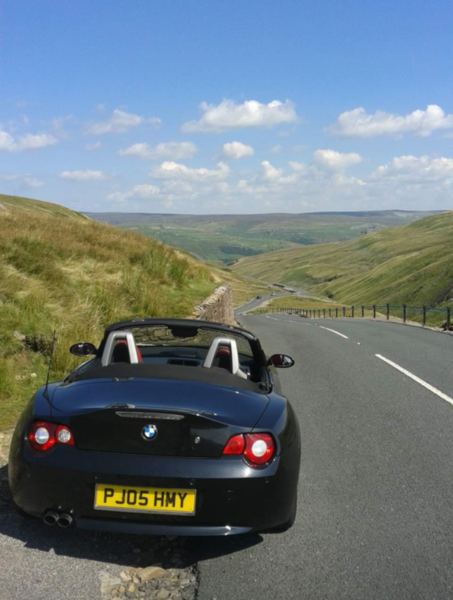

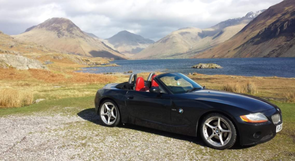

I used to own PJ05 HMY, I already carried out this mod before I sold it..
Looks alot better with blackout kidneys etc :)
