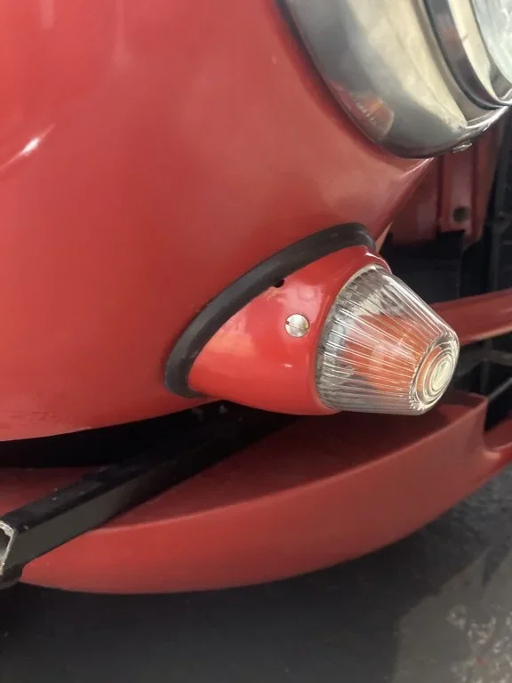

VW Karmann ghia indicators with the metal housing. Tribute are doing an alternative set up using round Lucas lights as the VW’s are quite hard to locate and expensive. You will have the choice when ordering I believe
@Dxbolton Please tell me about those front indicators. The outer metal housing you mentioned. Is it chrome or body color? How is that attached to the body? Is there some kind of bracket? Did you take a picture of it before bolting it on?
Thanks :)

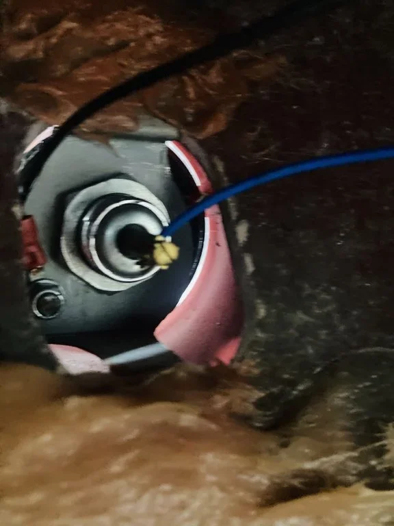

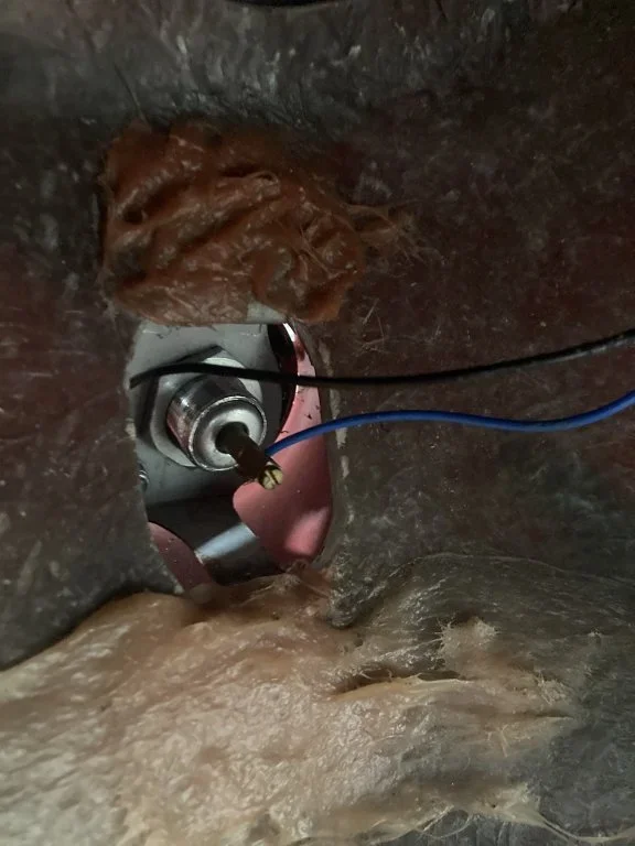

Mine are metal Karman Ghia indicator lamps. I have painted them body colour, Steve has bought chrome ones, I made a small metal bracket that I glassed to the body, and the large nut on the rear light then secured it all together

I got ones for an old VW bus
I suspect it'll be the same part on the ghia.
I got with orange hella lens. Metal is red!
I can change the color but was thinking of ways to mount to the body and still have access to change a bulb.
Thanks! :)
I think they are the same between various VW’s of the era. I painted mine to match the car and went with orange bulbs instead of orange glass.
they are quite easy to remove if I have to

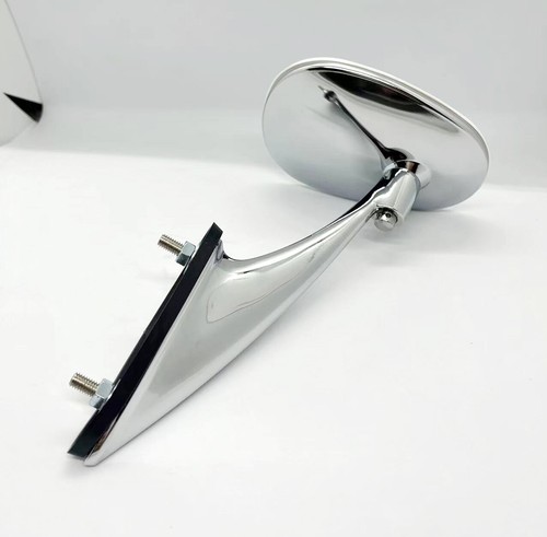

Hello @Dxbolton
Can I ask. What wing mirror have you used?
Does it work OK where it is?
Thanks
It’s an early VW or Porsche mirror with a long stem. Bought from eBay
It does work after getting the angle right which took a lot of time!
however I prefer to shoulder check what’s outside similar to riding a bike, as the mirror is more a style piece than truely functional

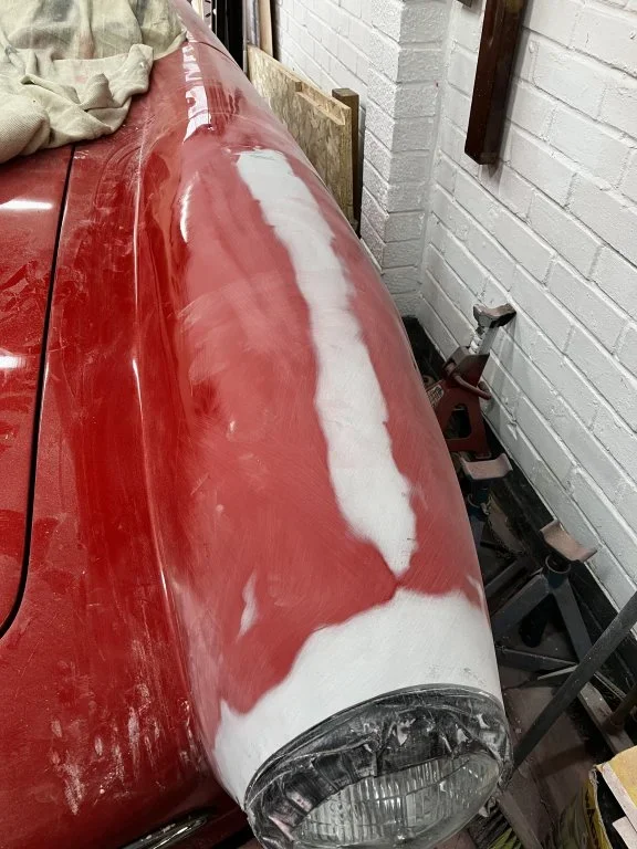

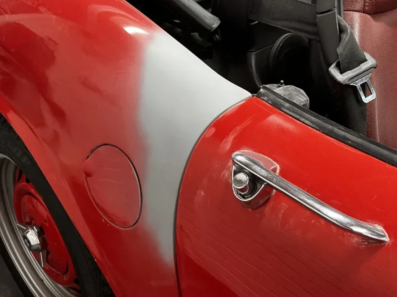

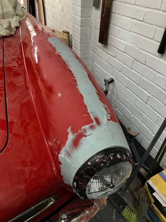

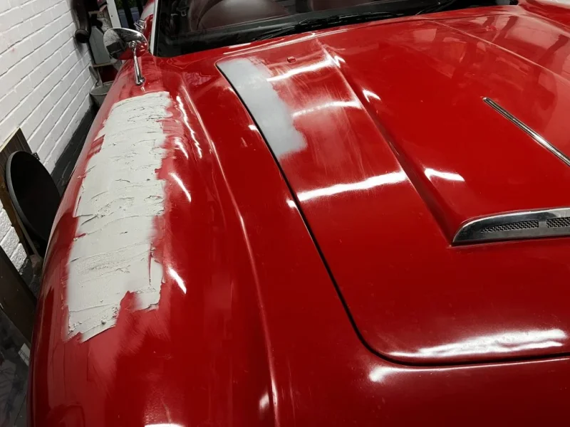

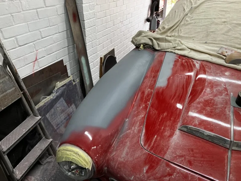

Well after 18 months of great fun in gelcoat, it’s time for paint.
so front wing tops have had the flat spots removed, door gaps are being made tighter, fuel flap is reshaped to contour of the rear body, and a few other parts tidied up. October is when the paint shop gets the car 😁
The flat spot on the driver's side wing. Did that go well?
If you've seen my build thread you'll know that I'm not afraid of choppin, fixin and fettling but I do worry about if I can do a good job of that flat spot. It's pretty big and getting the shape right will be difficult I think.
Looking forward to seeing your car painted. Mine's nowhere near ready.
