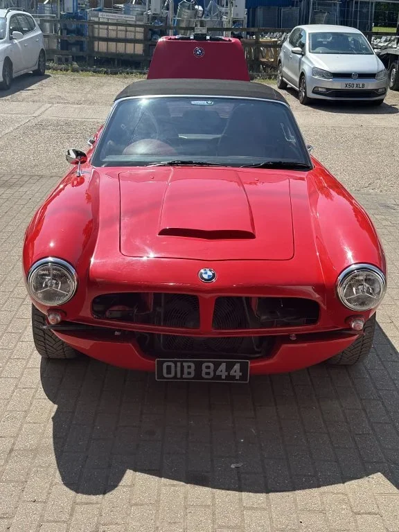

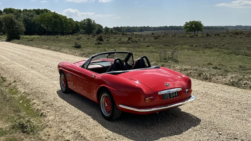

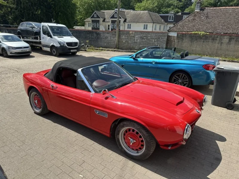

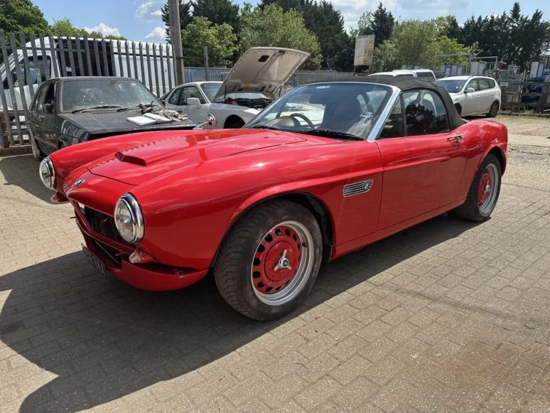

Moving forward, mostly just the chrome to refit
What's the colour?
Looks good in the photos; the panel gaps and shut lines look very even.
What's the colour?
It’s BMW Hellrot Red.
There’s a distinct orange tint in some sunlight situations, almost pearlescent, but it is the BMW colour.
i be spent a long time getting the gaps right,and it’s paid off.
I’m very happy with the result

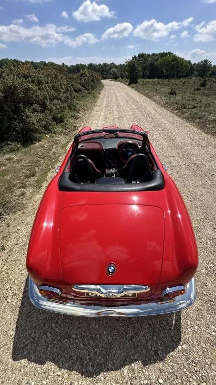

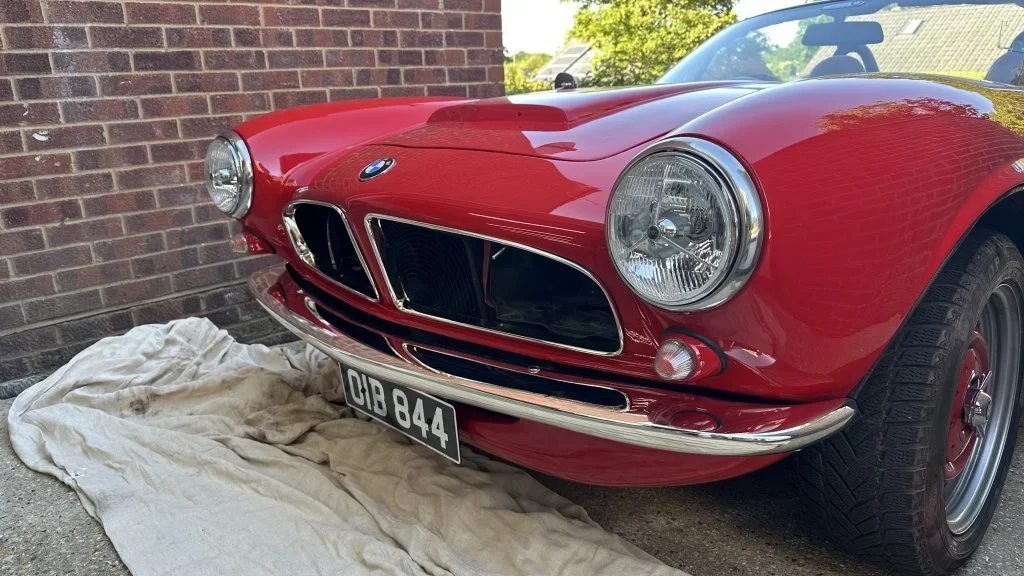

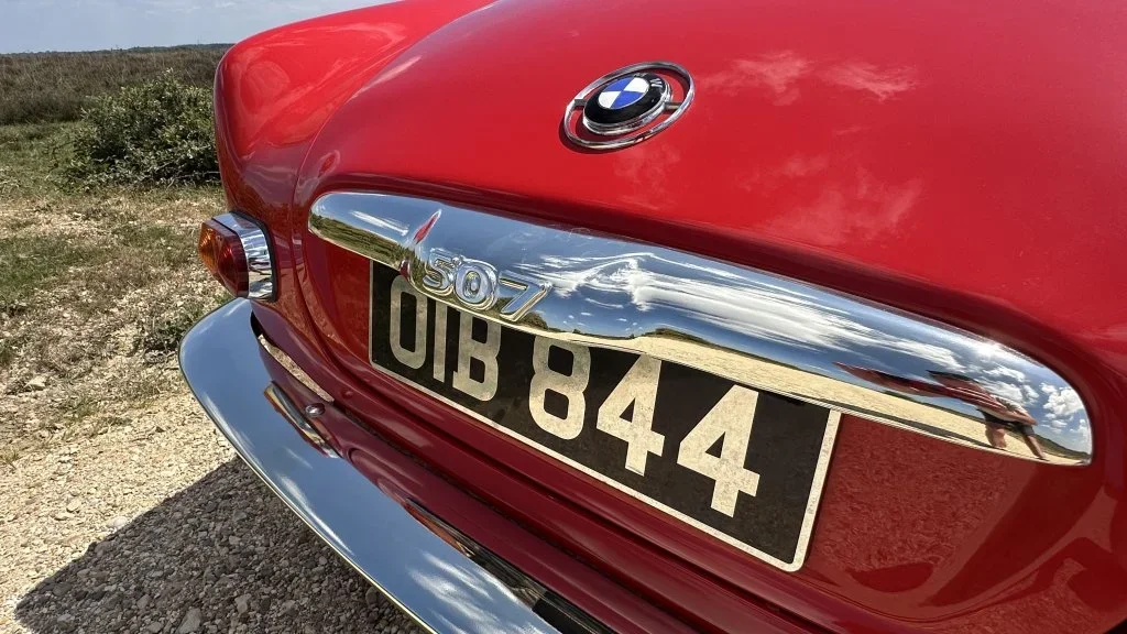

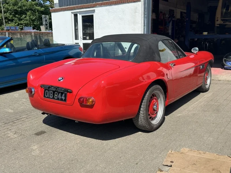

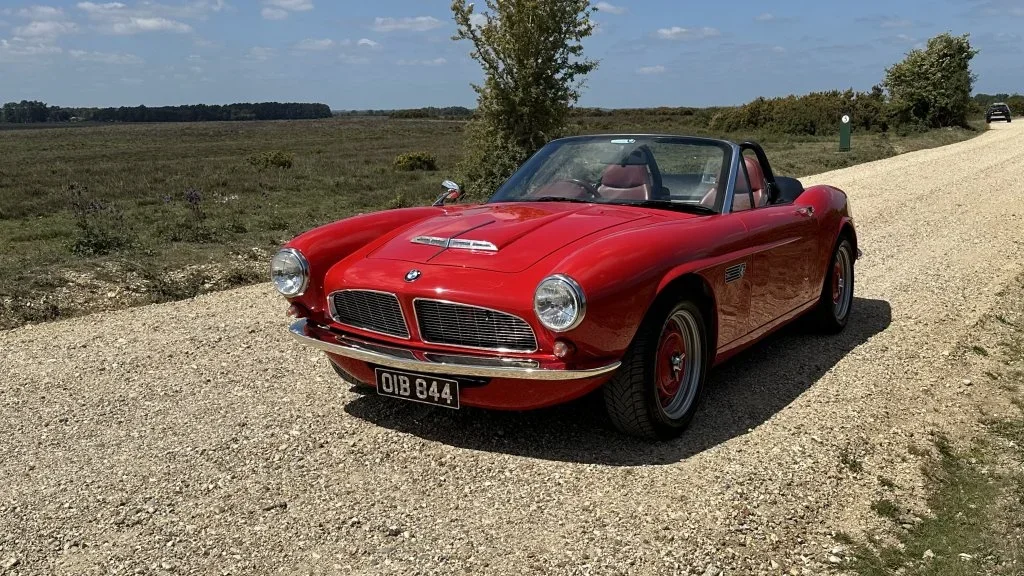

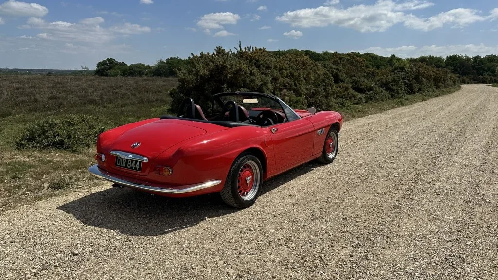

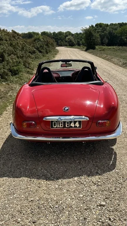

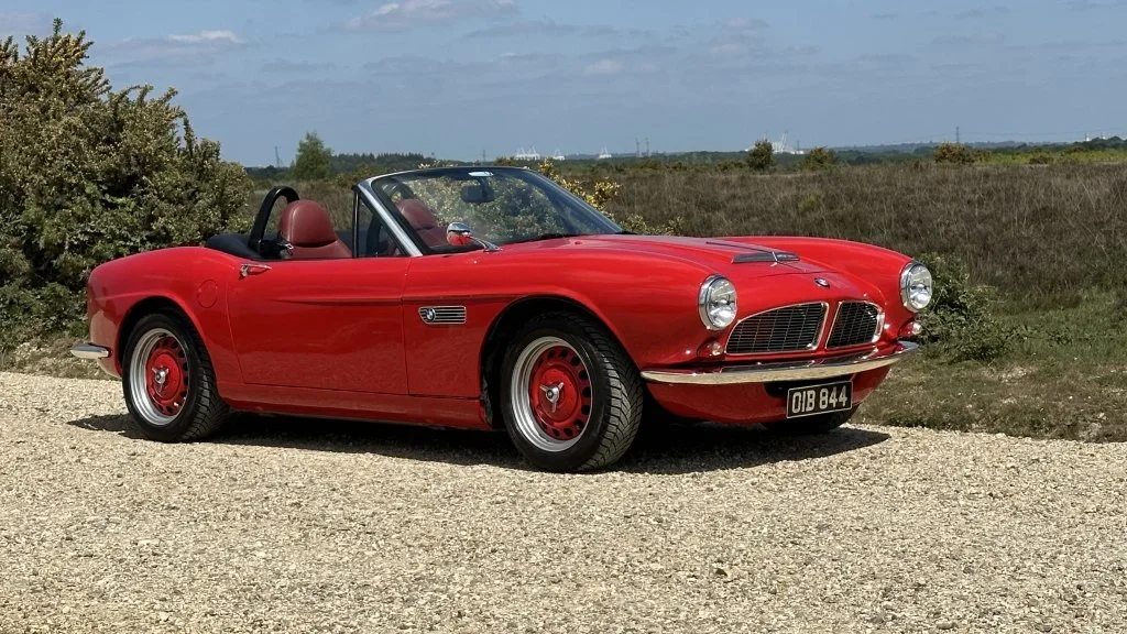

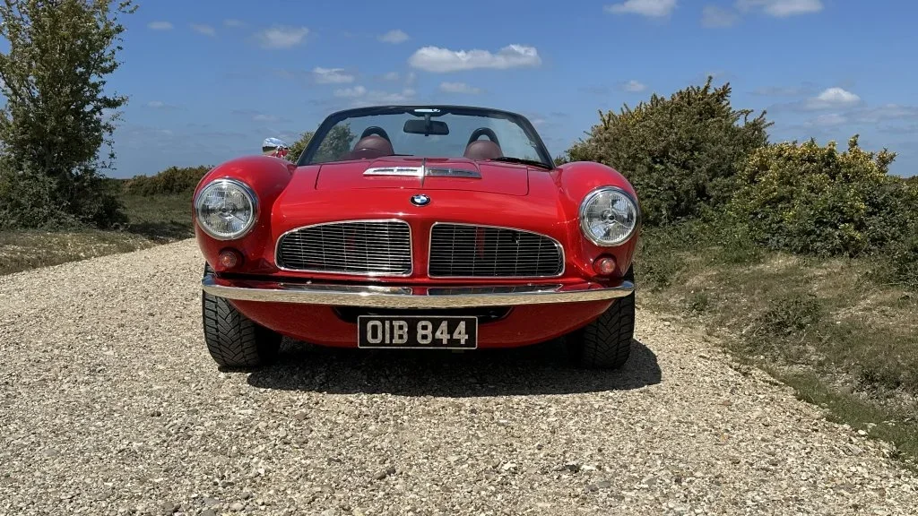

All the important bits now refitted

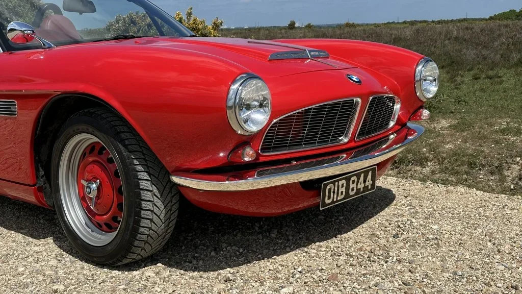

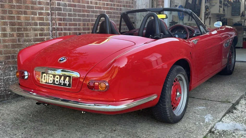

Looks very, very good. :thumbsup:

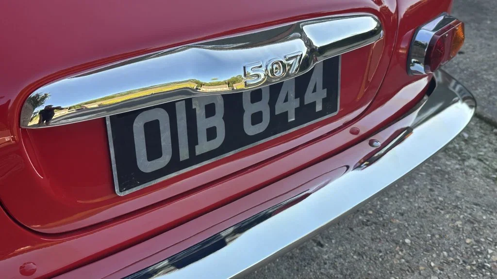

Are those the GRP bumpers, etc chromed?
Yes, boot handle, bumpers, and grill surrounds are all GRP supplied with the kit (boot handle was my design) from Tribute and all chrome painted by Wayne at Chrome Finish.
The size of the rear bumper is a challenge for this process but he’s done an excellent job,
I don’t think many people will realise they are not metal

That’s chrome finish looks good. I noted your number plates, can you actually use those on the road as the vehicle is not that old?
Yes you are allowed to use older plates on any car. What you cannot do is have plates that make the car appear newer than it actually is.
You are allowed to use plates with an older year letter. But, as far as I know, black plates are only allowed on cars over a certain age. 1973, or 75 i think.
Although there's also some rule relating to vehicles over 40. But not a 25 year old zed.
If you get a job's worth plod he can have the reg number confiscated/cancelled without refund.
Always have the yellow/white plates in the boot. If you get stopped ( unlikely) then it's "Sorry officer, I was at a car show and I forgot to change my plates back" Hopefully a wrapped knuckle and on your way. They're probably more interested in looking at your stunning car than doing you for such a minor issue.
