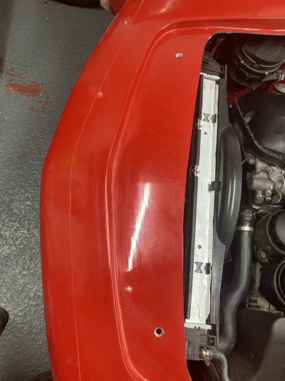

Side grilles have caused lots of head scratching and I’ve looked at numerous options. I’ve opted for M3 side grilles although I’d have liked something a bit larger like the original car. The idea was to install led indicators at the rear of the grille but unfortunately they didn’t show enough light. A friend had two small indicators that fitted between the grill fins so I have fitted those too. We think they are off a motorbike and removed from a larger housing.

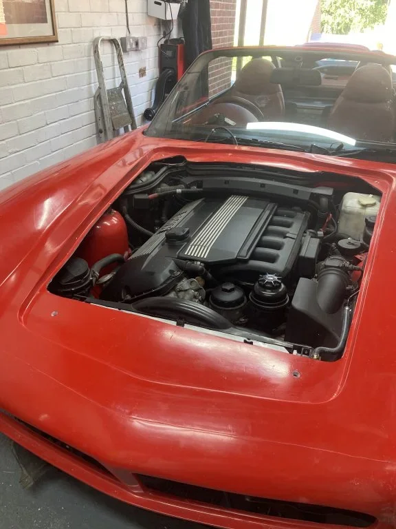

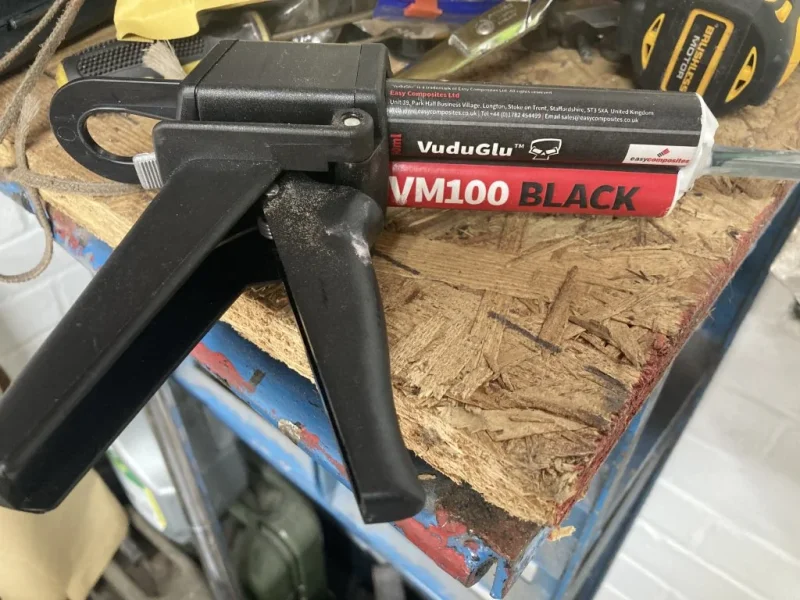

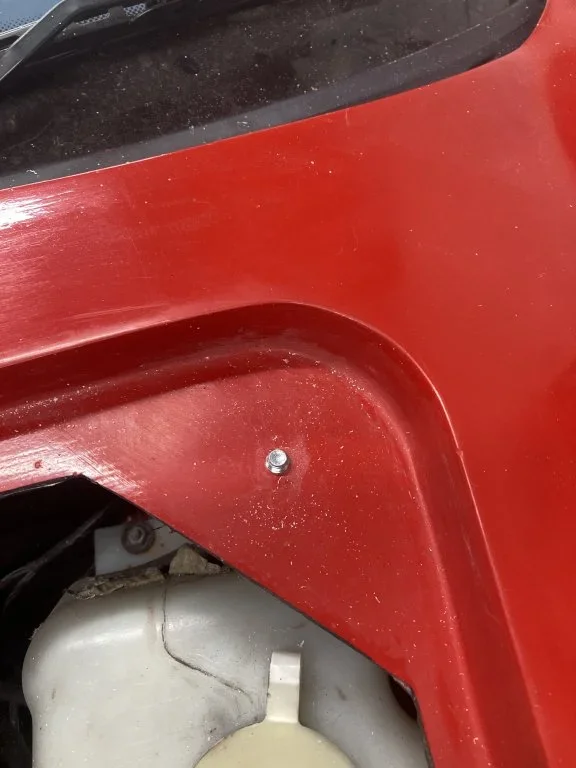

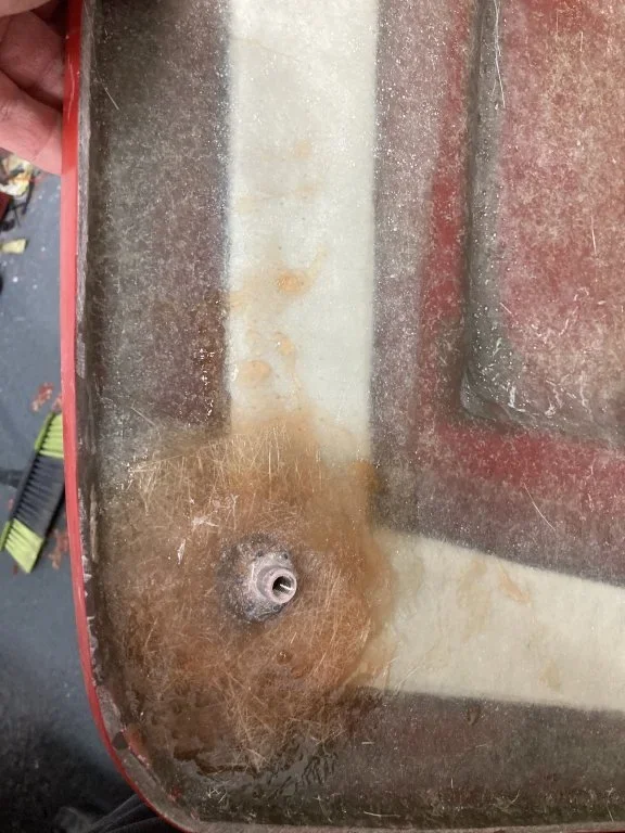

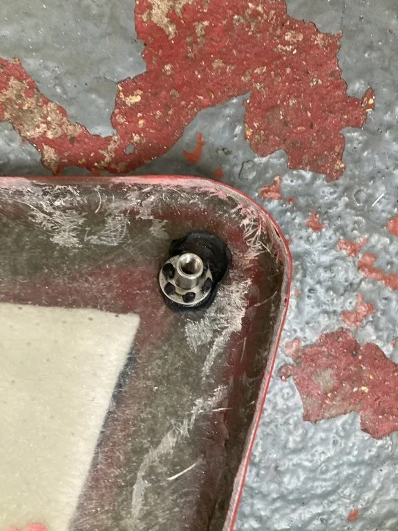

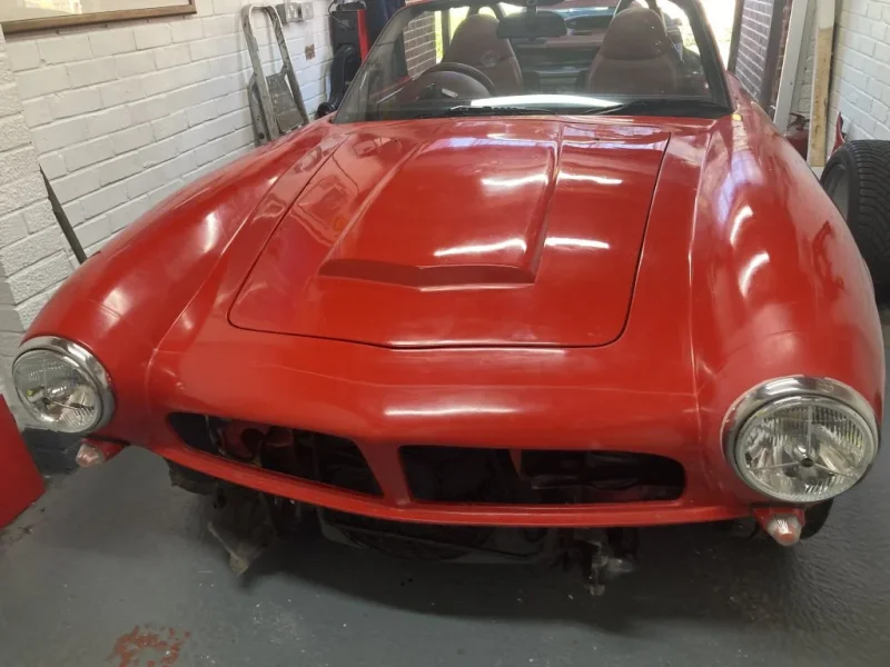

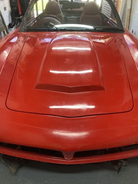

Today was playing with the bonnet insert and sorting out fixings. I used BigHead female blind collars which were stuck to the hood insert with ViduGlu. Once bonded I added extra grp to the front fixings for peace of mind as I don’t want it to part company whilst I’m driving.
once bonded 4 8mm bolts were installed to hold it all together.

Today was playing with the bonnet insert and sorting out fixings...
That is all looking so good. I hope you can get the bumpers to do it justice.

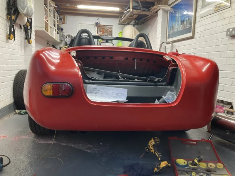

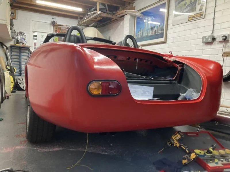

Been a bit slow but the rear tub is now installed And the nearside rear light unit. I just need to make a small bracket to mount reverse and fog lights under the rear edge. I have high power LED’s so they are small and hopefully unobtrusive

Today was like the hokey cokey with the bootlid, on off on off. Eventually a 2mm thick washer under one bolt
made the lid line up😁

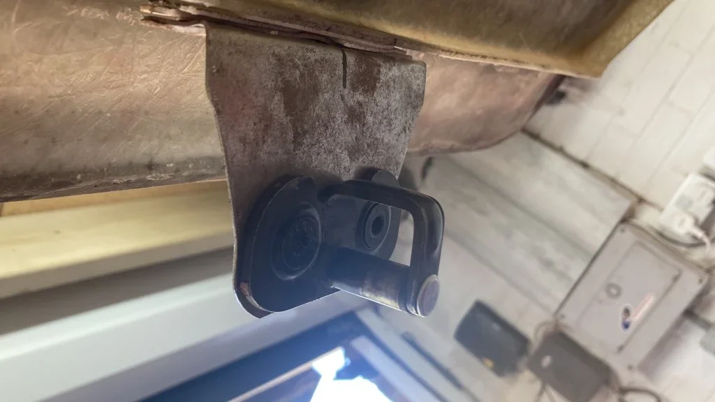

I welded the locating ball back onto the bracket so both gas struts would work. These are the original Z3 hinges so the struts push on the hinges and not the bodywork or boot skin so it should not cause warping to the skin at a later date.

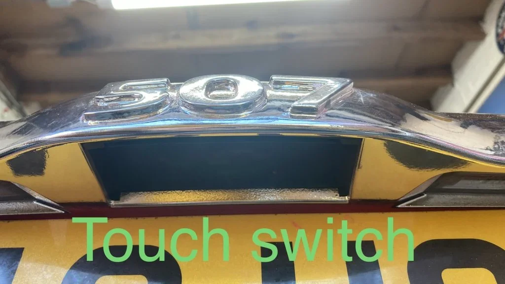

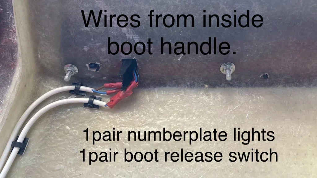

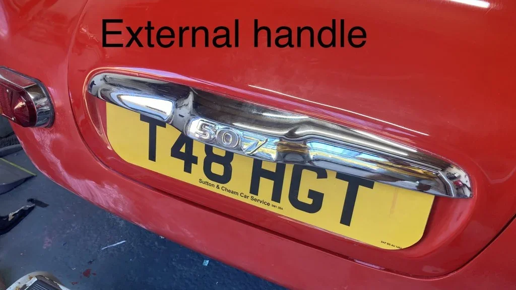

The 507 handle is now fitted and I’ll wire up the number plate lights tomorrow that are in the handle. Then it’s onto the lock mechanism.
The reverse and fog light LED’s were fitted on the lower edge and drivers side wired in. Passenger side to be wired tomorrow.

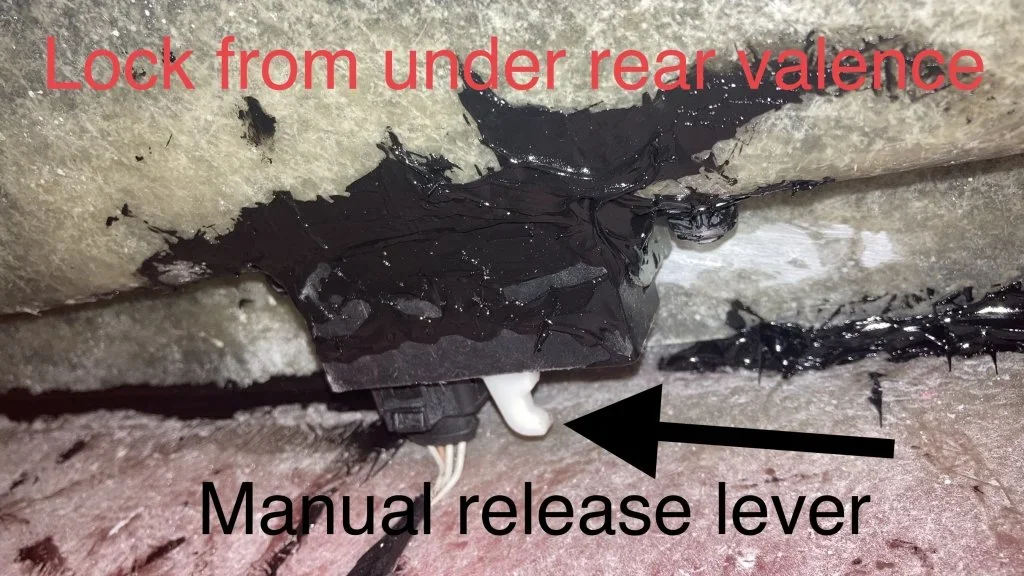

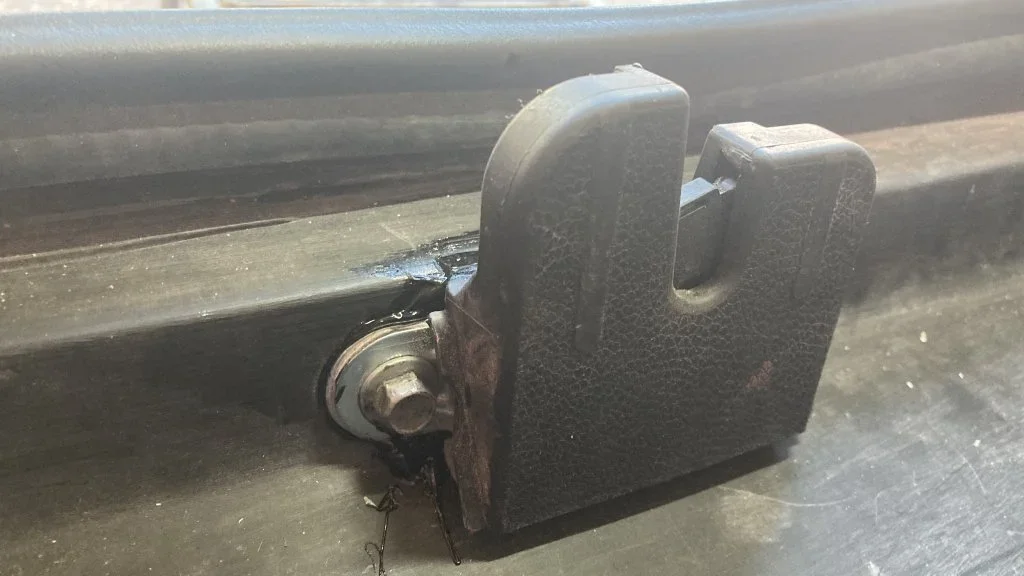

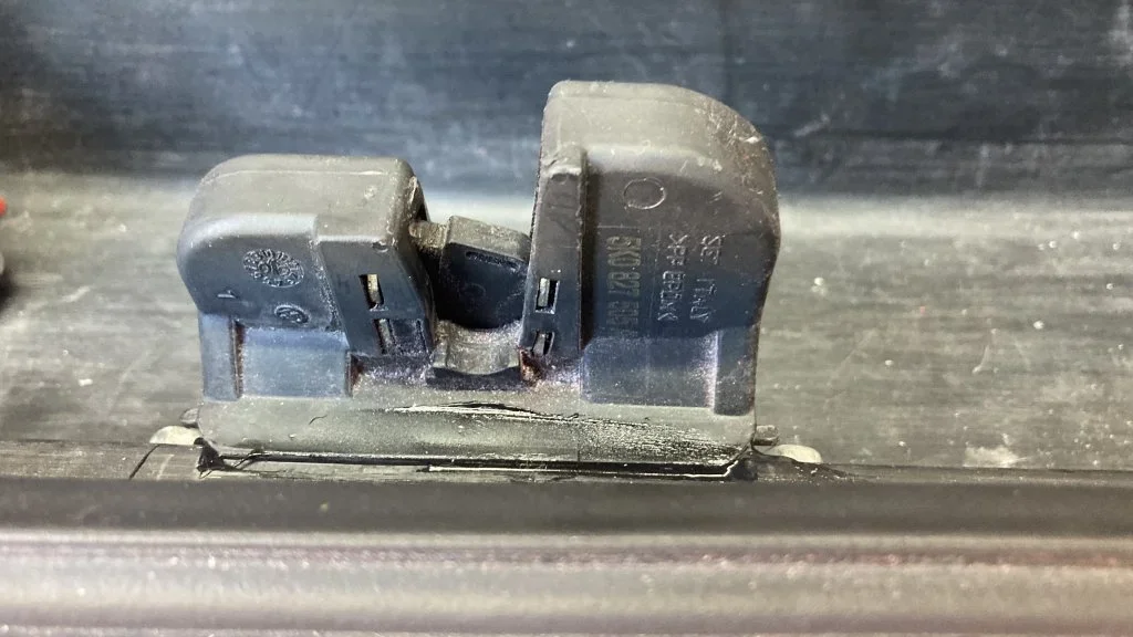

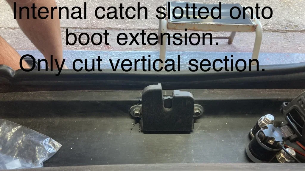

Time for the next instalment! Fitting the boot lock and release.
I’m using the Fiat 500 handle with a VW transporter electric boot release.

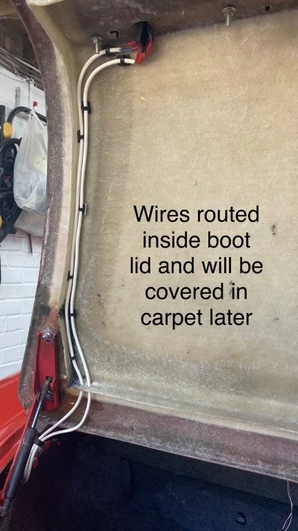

I have found a constant 12v live wire in the boot and ran a wire into the car to a hidden switch so I can keep the boot locked if needed. I haven’t found a way to make the central locking to work yet but have a few ideas that need researching.

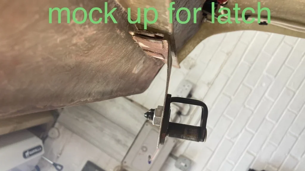

The latch on the bootlid will be braced with welded edges to box up the bracket and stiffen it, and then fixed into position on the boot lid. I can then adjust it height wise for a firm lock.
