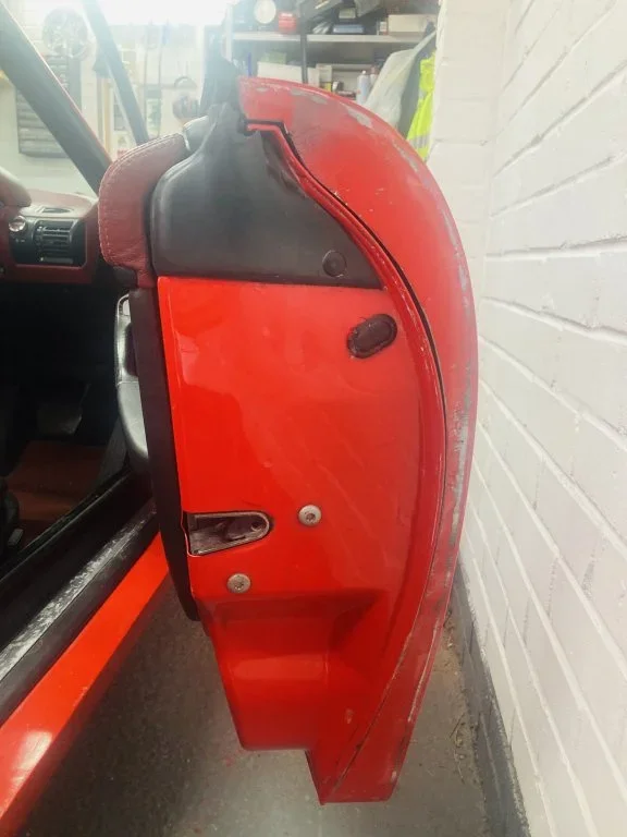

When the door skin is attached what's in the gap. Air? Padding?

The new skin overlaps the original and is secured by screws and brackets on the lower edge. I will close the gap tighter between the two skins in the next few months so it’s a tight fit.

The new skin overlaps the original and is secured by screws and brackets on the lower edge. I will close the gap tighter between the two skins in the next few months so it’s a tight fit. View attachment 275867
Thank you for the photo.

@Dxbolton Thank you. I must confess I was a bit worried when you said there was a 30mm gap between the door and skin. But your pictures explain it. Thanks.
No hurry. But next time you're by the car would you take a picture looking down on the door. I'm curious about how it attaches at the top. Sounds like it hooks over the top in place of the rubber trim? Does the kit require a different trim?

You remove the original rubber window seal, and the skin drops into the groove that it leaves.
I have reused the original seal on the new skin and it fits well. I had to modify the end slightly but it’s only Minor.
