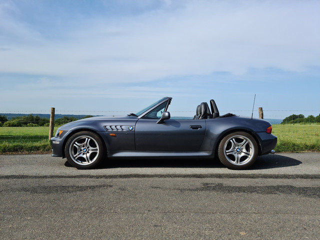

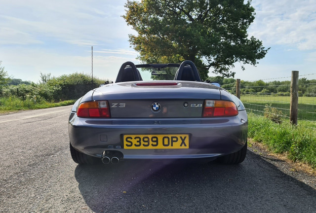

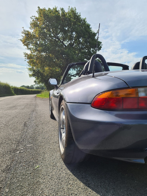

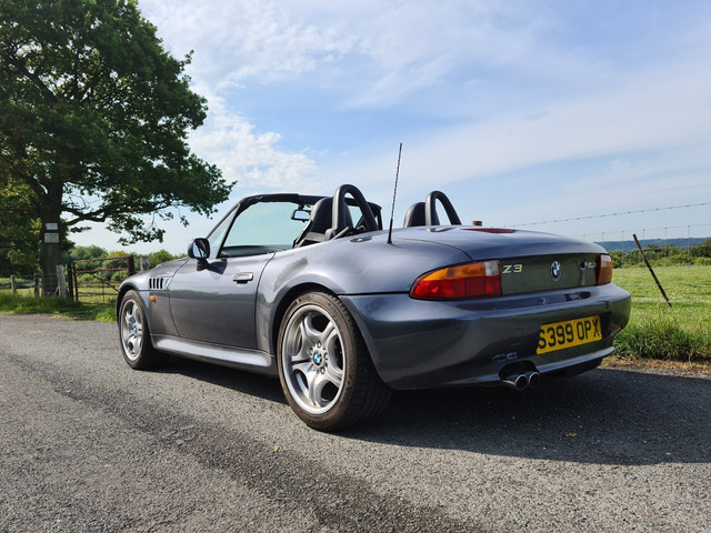

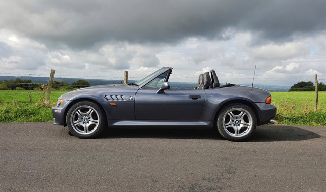

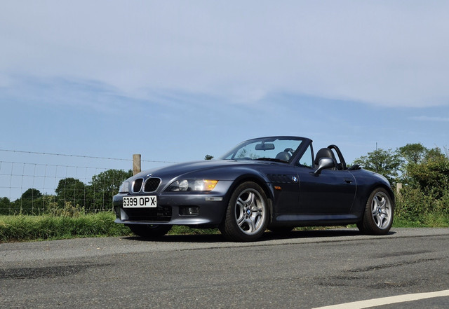

Just updating this thread in case anybody is looking to do similar. Eventually went with Bilstein B4 shocks, Eibach Pro -30mm springs, new 10mm spring pads and 10mm spacers for the rear - plus new ARB and control arm bushes.
For me it’s definitely the way to get a better look and better handling without sacrificing ride quality or clearance.
