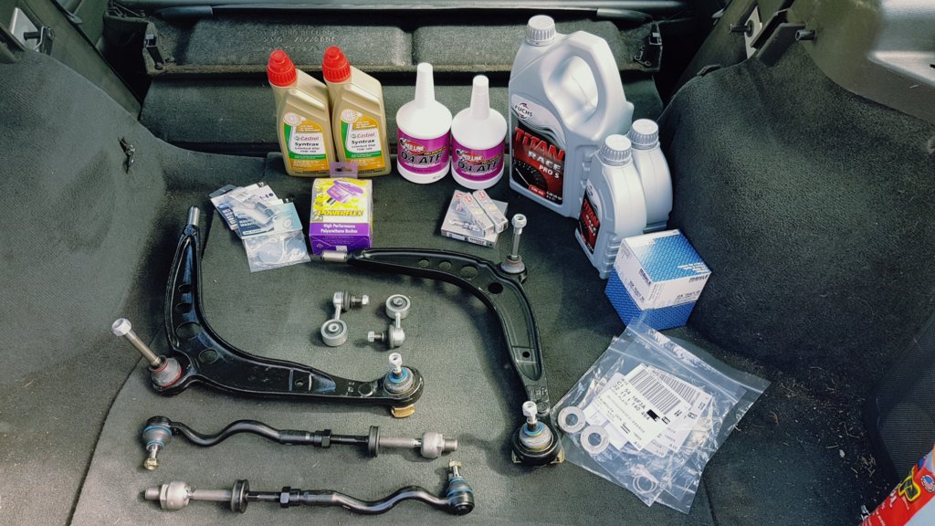

On the original topic, here is a picture of my haul last month, oils from Opie, these were their over the counter recommendations for engine, gearbox and diff oil for a 98 2.8 manual:
duckhunt
Mar 14, 2017
60
London
2.8
Photo uploaded small so
gearbox is redline d4 atf,
diff is Castrol syntrax limited slip 75w-140
