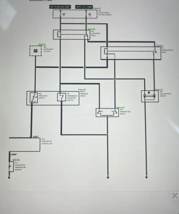

Is there anyone who can fully interpret the Realoem circuit below:
Edit: This hasn’t come across any better!
The Aircon cabin switch feeds into “The Evaporator Controller” which I assume is within the main ECU.
I can follow the circuit from the Evaporator Controller but clearly have no idea how the Controller is programmed to provide a switch on signal to the rest of the circuit. It can not be a direct switch from the cabin switch, otherwise the Temperature sensor that feeds in to the Controller has no impact?
