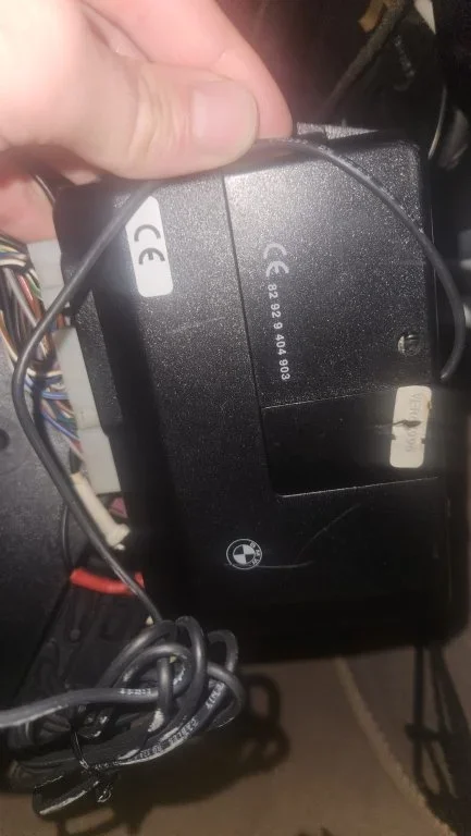

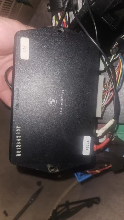

Can you take a pic of your alarm module, it would be helpful if any part numbers on there as well to try and pencil it down for you.
Hi, sure. Part number is: 82919408596. There's one well priced at £45 on ebay currently that matches. If youre able to help me work out which key should be paring with this module it'd be much appreciated.
I can see that there is 5 keys synced to the module from my diagnostic so a chance thks key is not an original.

From memory that unit looks similar to mine which I have the separate brick remote and my key has no remote functions only a light.
The part number you gave only shows for series 3,5,7 in Realoem. For mine Realoem gave part numbe 82919404777. Hopefully the remote you have ordered will work with your suspicion.
