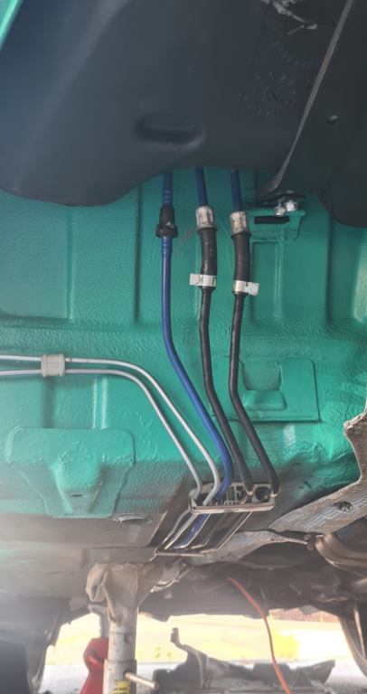

What did you end up doing about the bracket for the fuel/brake line, where the clip had sheared off leaving the screw in the threaded post? I can see you managed to get it sorted!
Lovely job that mate. Those rear drop link lower brackets are sided and have a very slight twist to them, Best way to get them right is when its all back on the car and the arms are raised.
erm....er...um...I haven't...it's what they call "youtube ready"...because the pipes slightly splay out the clip, I was able to clip on the metal cap as it has a little metal tang. I could just pull it off again. I do need to sort that.
one thing I did think of was cutting the shank off a bolt, JB Welding it to the stud that's left and securing with a nut

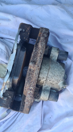

First challenge was trying to get the caliper off... don't think the offside one has been off in decades.... couldn't get the hose out so had to sacrifice the pipe and the spring clip...
These were all my instruments of torture to try and get the caliper bolts off !!... :whistle: :whistle:
but..... we got there !!.... the brake union was solid in the hose, so ended up putting it in the vice and using a flat spanner on the flats on the hose end to get it off.... looks like I'm making new front brake lines as well !

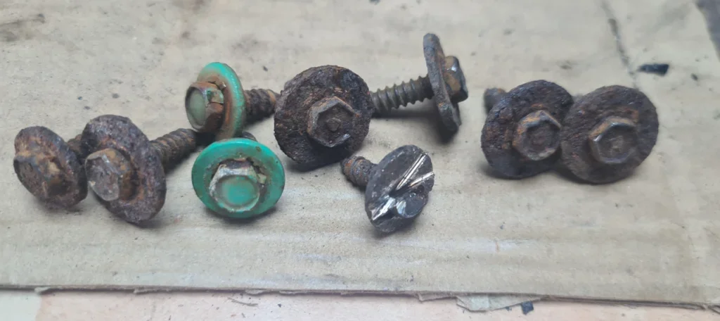

So after hours thrashing like John Cleese with a branch on an Austin 1100... this was the total haul for my efforts... and I've got to do the nearside as well yet ! :whistle::whistle:... I know I should use the nugga gun... but after my nightmare with that driveshaft nut two years ago, I'm mentally scarred

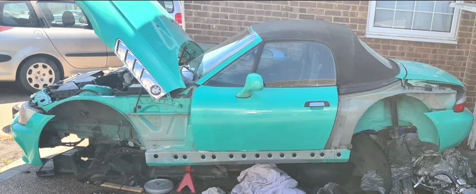

ok Bank Holiday weekend, and I'm not going to try and spend every day under the car...... however... while I'm here......

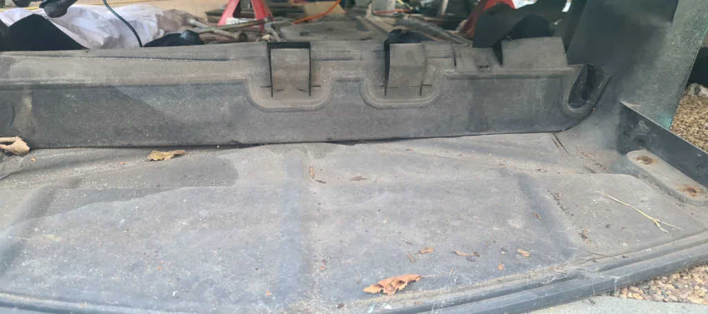

I took the front undertray off...... oh... and guess which one was the last screw I needed to get off..... ? :whistle:

Caliper I fitted a few years back still really good !.. and at the same time I fitted a new brake pipe which unscrewed easily !!... and plenty of meat on those shoes, so they're going back on...

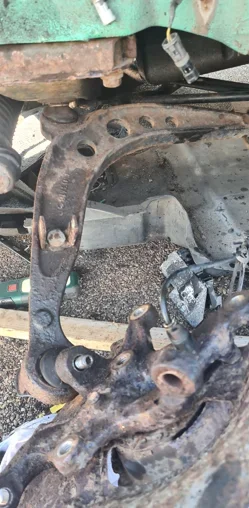

So this time a tried a different approach.... get the wishbone (lower control arm) off and take the bits off in the garage..... first was getting onto the 22mm nut... and with the undertray off it was easy to get to ... but had to use the "double spanner" method to get any leverage....
As you've probably experienced, you get about 10 degrees of turn and have to keep repeating it until it's off....so with that nut off, the lollipops off and drop link off we get to this....
undid the offside one as well...

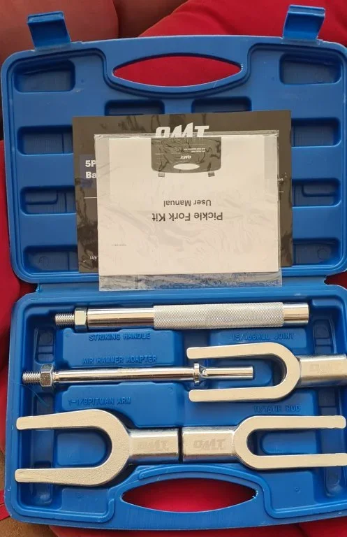

and that left me a bit stuck as I can't get that centre ball joint off. Tried crow bar, tried banging... so if you have any tips I'd appreciate it

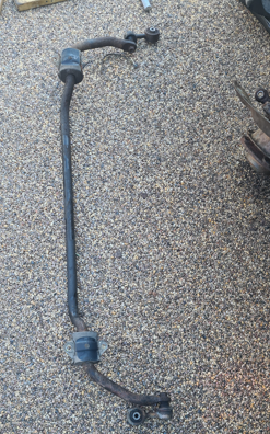

so while I was mulling the meaning of life... I got the anti roll bar off...
So the car now is the lightest it's going to be :party:.... actually no, as there's the tie rods to come off.... caught out on a technicality
Thinking of pimping my ride...=))=))
so this is my weekend haul !... the car got lighter... and the garage got heavier !!

maybe some blue lights under the sills and a massive sub woofer ?.... luckily I was in shade for the nearside :party:
I think the blue lights will be on the car following you if you dont extend the wheel arches :whistle: :whistle: =))=))
I had the same problem separating the center wishbone ball joint from my front subframe. I purchased this kit DAYUAN 5 pcs Ball Joint Separator... https://www.amazon.co.uk/dp/B08M611VRD?ref=ppx_pop_mob_ap_share It took some hammering and the tool held up well. I don’t know how far you are from Banbury but your welcome to pop over and borrow it or just bring your subframe over and sort it, give it a clean up and epoxy paint it while your here?
thank you so much mate, I really appreciate it..ironically that's exactly what I've just ordered off Amazon!..I'm in Portchester which is about as South as you can get without getting wet..when I'm on four wheels I'll come up and visit !
ok, so it's Saturday, and another day on the car....firstly.... "new" shocks turned up on Tuesday courtesy of eBay. well.... better than the ones I took off !.... they'll get rubbed down and sprayed gloss black.... :party:
Then I attacked that lower control arm with the pickle fork and OH MY GAAAAAAAAAD.... both came off in about 10 minutes !! ..used it as well to separate the lower ball joint from the knuckle... so as @Althulas suggested, these are DEFINITELY the way to go if you're not planning on putting those ball joints back on.

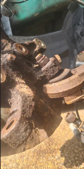

so for posterity when I look back, this is the state of the hubs...
