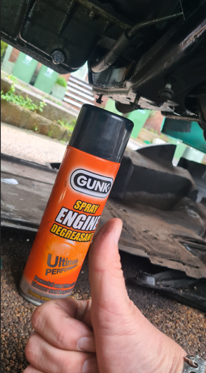

soooo about that leak :whistle:
Thinking on the plus side, it stops things from rusting !.... so with my good friends Gunk and brake cleaner I set to work.
subframe and steering rack came up really nicely. Especially those power steering labels !
I was tempted to put the new brace on, but I'm sure I'll find some more to clean under there...
