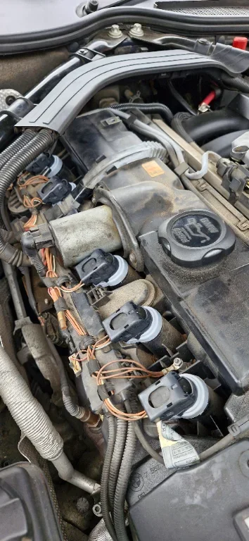

New set of Bosch coils.

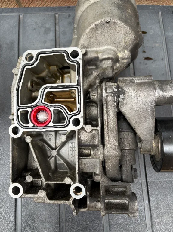

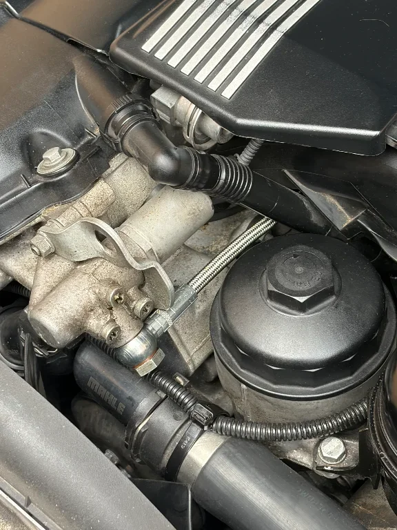

More preventative maintenance, Oil seal (febi bilstein not the one that came with the valve), Check Valve and Braided Vanos Oil Feed, followed by an Oil and Filter change.
