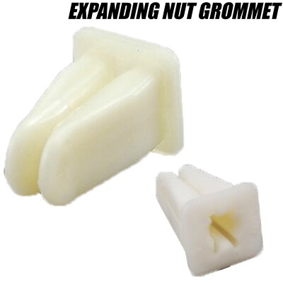

Does anyone know if you can source the little white plastic inserts the jacking point screws in to? Rather destroyed mine. Can always 3D print something but surprised I haven't been able to find them to buy.
Also cheap from the dealer as well.

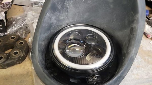

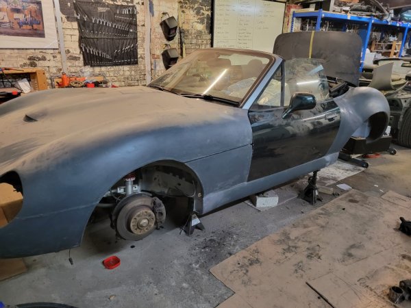

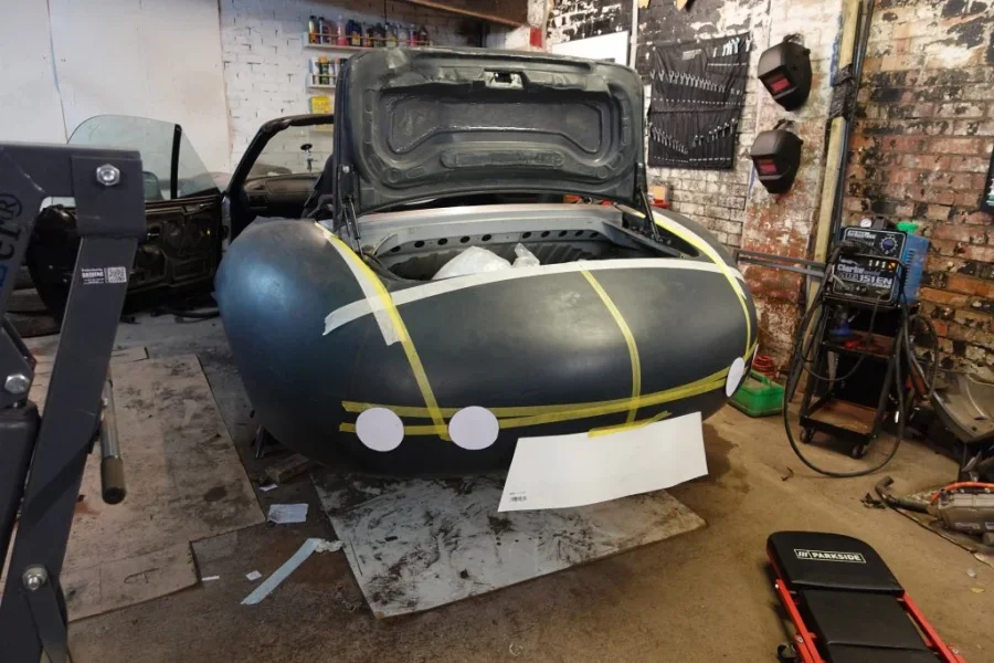

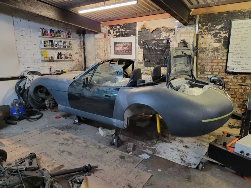

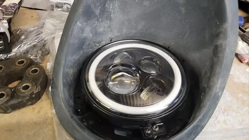

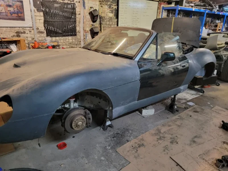

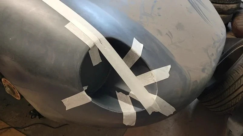

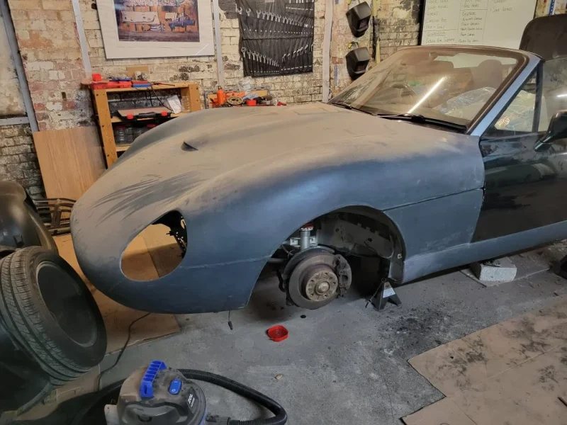

Making proper progress on the body swap now. Headlights half way to being mounted, working out the boot catch, and laying out the rear end lights/number plate.
