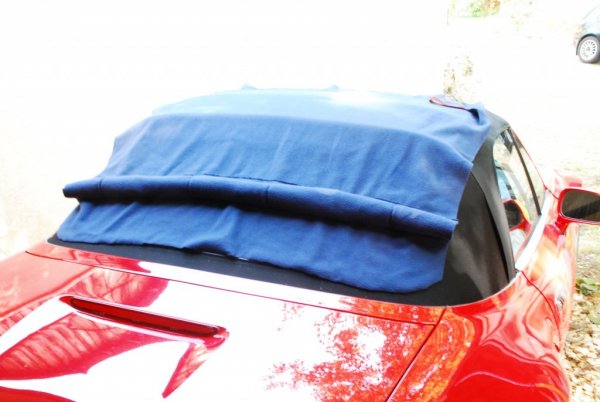

I have always cleaned and polished such windows with whatever wax I used on the paintwork, and in fifty years on various cars have never had any problems, except on the original window on my Z3, which developed a cloudy appearance even after using BMW's special cleaner. The window of my current hood (from Car Hood Warehouse of Chessington) remains perfectly clear after about ten years of use and wax polishing. It is also thinner than the original, and therefore folds easily, with no rish of it splitting in cold weather.
A good way to prevent scratches on the rear window is to always brush any grit or leaves from the seam above the window before lowering the roof. This is the cause of the usual mark across the half-way point of the window.
Another good dodge is to use a hood blanket of some kind. The BMW version is made of very thick felt, which provides a decent bend radius for the window, in addition to reducing con tact and polishing between adjacent area of the hood.
The problem is that it is bulky, so I designed one made from a fleecy blanket, secured by a short velroc strap above each window, with a tubular pocket to hold 4 short pieces of foam pipe lagging. It therefore folds up nicely, and also doubles as a pillow when camping!
