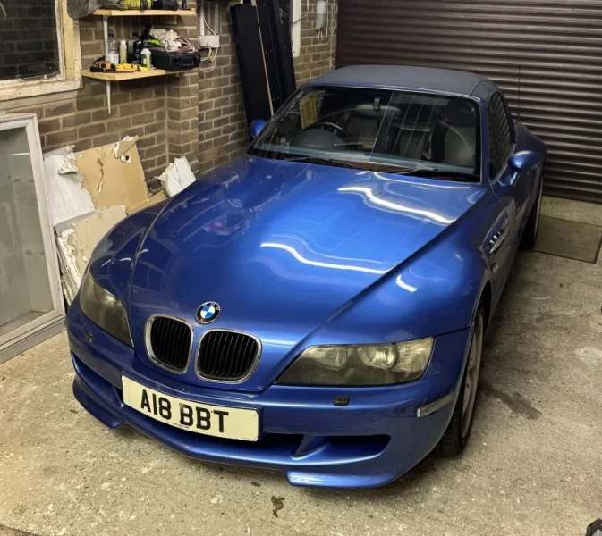

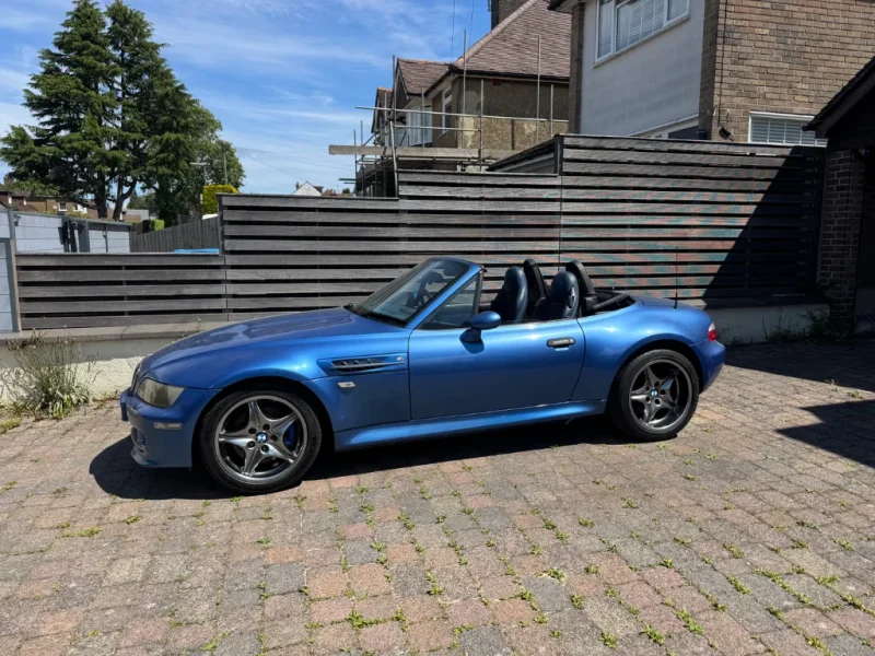

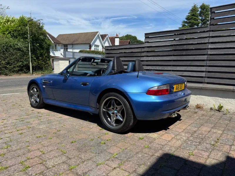

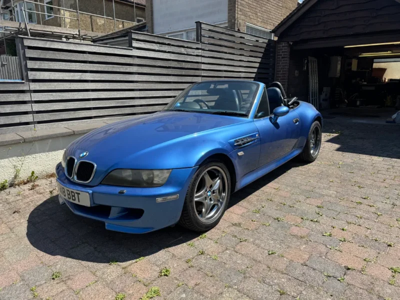

As a very brief update. Many thousands later and 7 months off the road. It’s almost ready to be back on the road!
Lee, can you drop me a message and I will send you back the rear springs you kindly donated to me!
Still much more to do but I want to drive it before I tackle paintwork and things!
