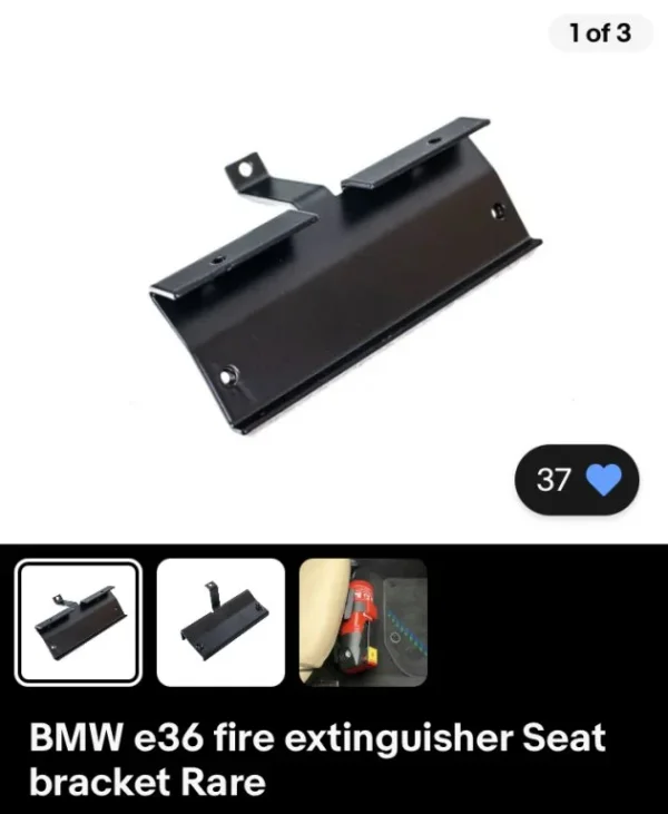

Where did you buy the holder? I have mine in the trunk but perhaps it's better in the cabin 🤔

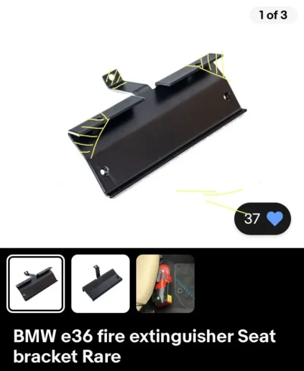

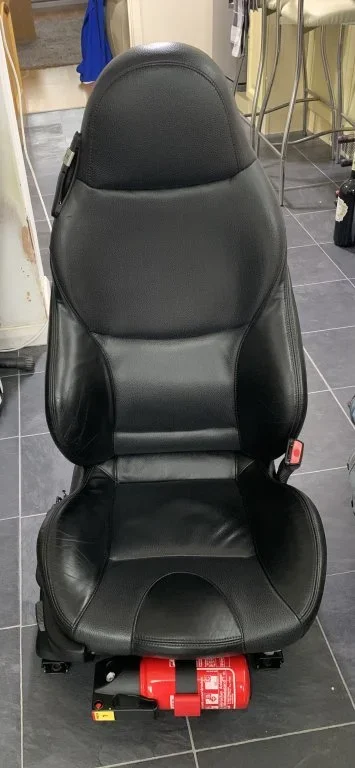

I used this but it took quite a lot of modification to fit it to my sports seats. It was to wide so I had to remove the corners back to the holes (taking the pre-drilled holes out). Drill new holes at 100mm pitch, shorten the third bolting point and bend it a bit here and there. Other than that it fitted like a glove. It is listed as a E36 bracket so I knew I was taking a chance. It might fit the standard seats as is but I don’t know for sure. There is a thread on here about fitting the fire extinguisher that shows the shape the bracket should be
