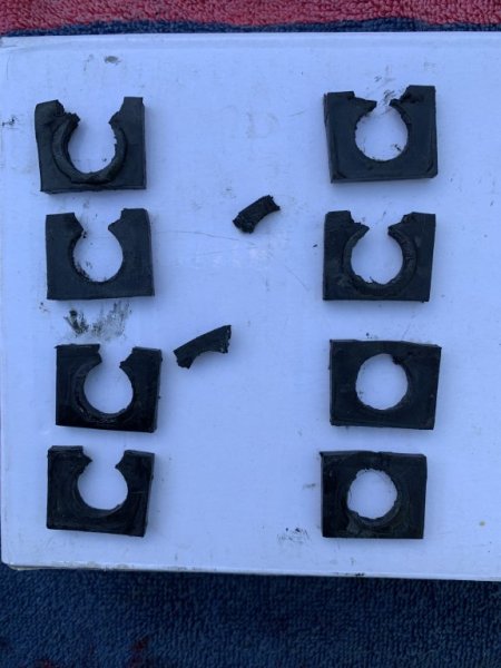

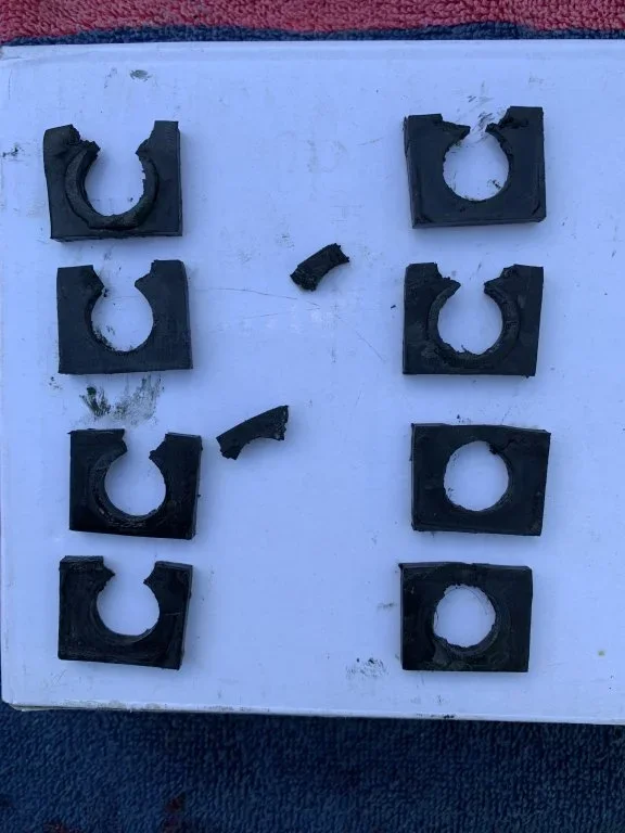

Spent a couple of hours today, sorting out the rocking seats. Used the opportunity to give the carpet a clean as well.
You have old bits that still look almost like old bits. I did mine a week ago - there was nothing in there at all. Just mush.
Once done it feels really good though doesn't it.
Not had chance to drive it yet. I agree it should feel better as the seat moving is quite disconcerting.
They weren’t moving as much as some I’ve see on YouTube just enough to feel weird.
My car is a Japanese import and only done 30k miles so I guess that’s why there was some bush left. It does show that age can have as much impact as millage and I have had to replaced a lot of rubber parts in the two and a bit years I’ve owned it.
