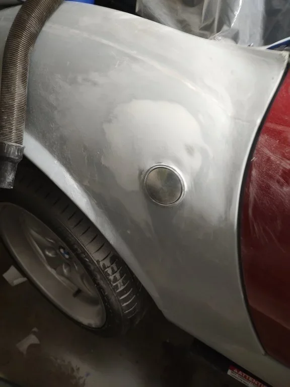

Started cleaning the body up. Sanding down all of the joining lines and making the area around the fuel filler look better.
I marked some spots here that I will address later, but both rear quarters will need to be modified quite a bit. I'll get to that in a moment...
I'm happy with how the fuel door turned out. It will be nice to be able to fill the car up at a gas station without getting weird looks. (Picture someone elbow deep into their wheel well fishing for the fuel cap.)

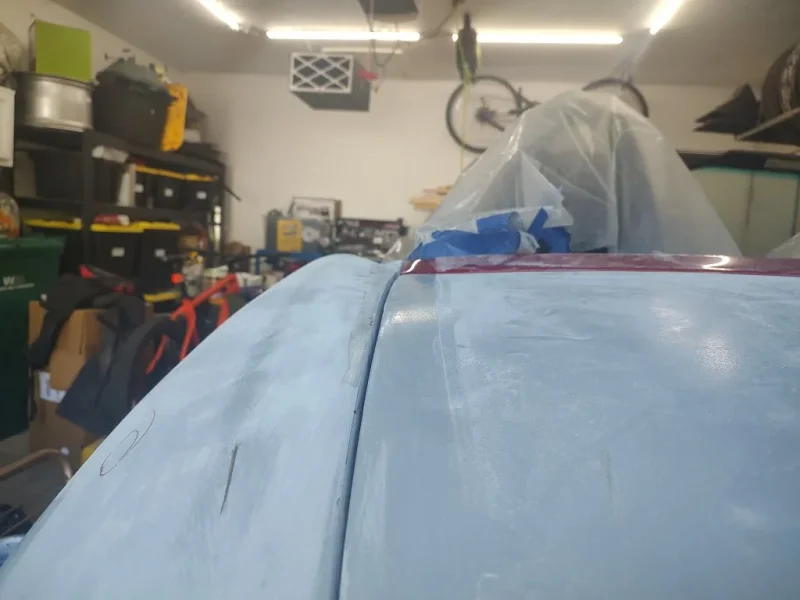

Here is a problem. The rear end is now fixed in place, but look at the panel gaps. There isn't one between the original red panel and the quarter panel. I can't just shave the quarter panel because the panel gap will look super weird as it transitions to the trunk gap. Another option is to cut the rear quarter and shift the entire panel gap which would require widening the trunk. Third option is to maybe put a small 2" rubber piece there to cover it up on both sides. Forth option is to just live with it. The other side of the car has a decent gap, so it is not symmetrical (this bothers me). I haven't decided how I'm going to do this.
Didn't I already post this picture? Yes, but now we are looking at something else. Look at the trunk. It sits flush with the rear quarter panel up until the body curves down, then the trunk sits proud of the body. I think I'll have to build the quarter panels up to match the trunk here. The other side is very similar. I can't do any of this until I finish getting the trunk to sit right though...
I'm also debating on shaving the rear lip to make the body and trunk flush together. This would require building up the body from the back so I have enough material to shave off. It would be a lot of work and would be shaving off a LOT of material. Roughly 2-3cm!

Next step, sanding down high spots and working on panel gaps. The driver's side was sitting quite a bit higher then I would have liked, but I sanded it down and I think I got it relatively good enough ish.
The passenger side wasn't near as bad, but it still needed work.
The panels gaps are coming along, I'm very close to calling them good enough.
One of the last body shape questions I'm considering is dealing with the lip on the back..see here:
I'd really like it if I got the trunk flush with the bottom edge, but there are only two ways of doing that. Build up the trunk (meh) or build up the back side of the bottom edge and grinding off nearly 25mm of fiberglass. The more I think about it the more I'm thinking it's not that big of a deal. I will clean it up some and focus on fit and finish.

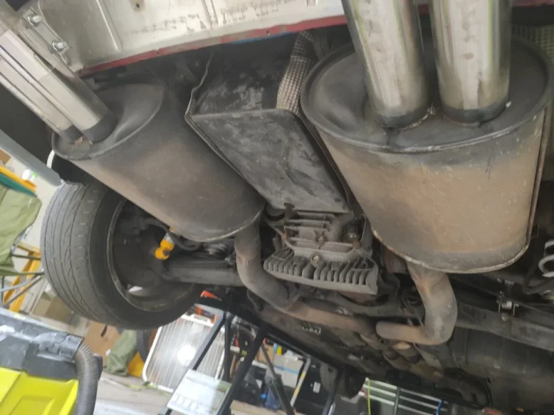

Now I have to figure out the trunk latch situation. My original idea was to use a classic hood pin, but upside down. The idea would be that the trunk lid would have the pin and you would unlock the trunk by reaching your hand under the lip of the body (between the exhaust pips). It occured to me that this car is very low and I am very tall. I'm re-considering my options. I can't put the standard 'T' handle under the license plate, there is no room. US license plates are taller than UK ones, so if I fitted a lock it would have to be either behind the license plate or off center. hmmm..
See? No room for a trunk latch. Unless off center somehow? Flip up license plate to reveil a latch?
