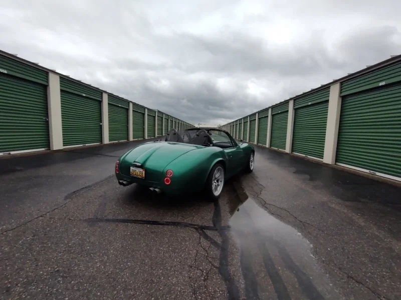

It's been a minute! I had to relocate the car and found a storage unit of all places to finish it in. Good thing everything I have is battery powered. I'm wet sanding everything by hand anyway.
So latest updates...
Car is in a new home:
